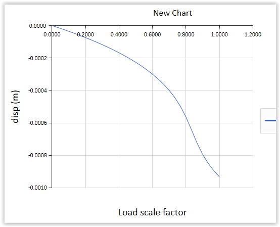

In midaxNFX nonlinear static analysis, we can set the number of increments. The solver applies the static load incrementally. We obtain displacement data for each scaled load. A plot can be obtained as the attached.
Can I do the same in COMSOL for stationary study (geometric nonlinearity checked)? Auxiliary sweep seems to be a choice. Is there any other option?
