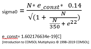

I found out that sigma0 is conductivity of the material which is defined as sigma0=(charge_mobility x q x n). Mobility is the function of doping density (charge density 'n' assumed to be equal to doping density) (see the screenshot attached).
My understanding is that the sigma0 terms in the piezoresistive coef. help adjust the sensitivity of the piezoresistor according to doping. Comsol has the sigma0 term to adjust piezoresistance of the resistor according to its doping... so doping goes up. conductivity increases and piezoresistance decreases.
Hope that helps!
