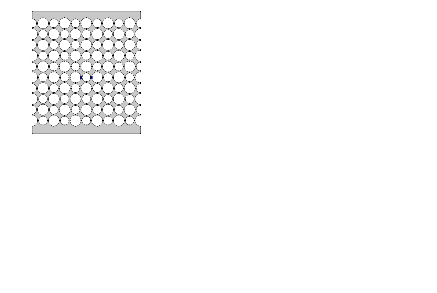

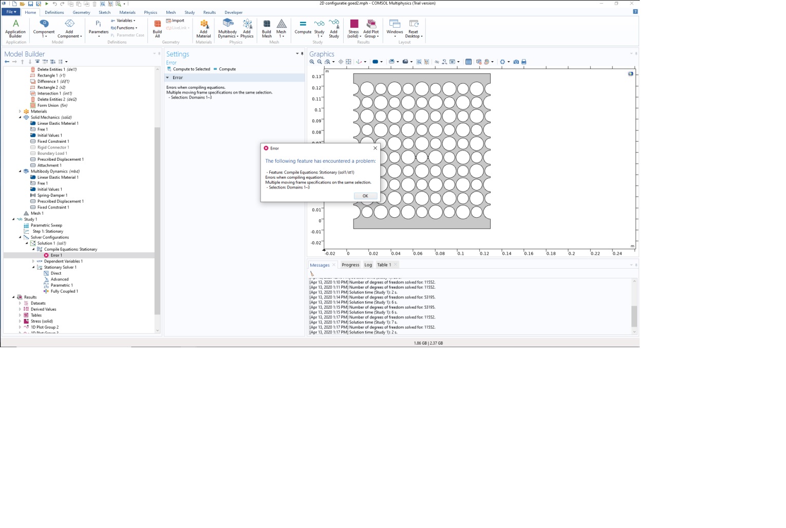

My model is indeed in solid mechanics interface and I want to model the spring damper in that interface. Like you said in your first solution you said that you can use the Spring-damper node from the Multibody dynamics in the solid mechanics interface by using an attachment. However when I do that I have a Solid Mechanics and a Multibody dynamics but I cant run both (multiple moving frame specifications). How do I use the attachment made in Solid Mechanics without running both physics (solid mechanics and multibody dynamics).

There could be many ways to resolve multiple moving frame issue however the change suitable in this case is to remove any domains selected in the Multibody Dynamics. The global nodes like spring-damper, joints etc. can be (should be) used in the Multibody Dynamics without having any selection in the physics in the case when attachments are defined in some other physics. Hope it helps.

I figured out a working model with a predeformed spring in my porous structure.
Still I have one problem and that has to do with the non linear convergence of the solution.
When I add more springs in my model there is a point where the stationary solver wont converge to a solution (already at the first step). I use fully coupled stationary solver with Automatic highly non-linear as the non-linear method. Do you have any tips or suggestions on how to improve the nonlinearity in my model so that the stationary solver will find a solution meaning it converges?
