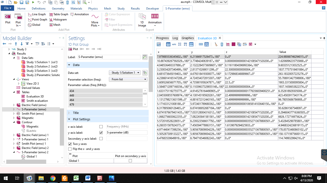

Hello, I'm Rara, Im doing my research on metamaterials for hyperthermia treatment. I've just finished with my Complementary Split Ring Resonator (CSRR) simulations. I found the cut off frequency. But, I'm confused that I don't find any S-Parameters data sheet (S11 and S21) and I need to use that data so I can see the differences of gap for the frequency.
Those, I attach my simulation how itdisplayed after the simulation.

Under derived values, right mouse click and select global evaluation and add it to the node. Using the + sign, add s-parameter emw.S11(or whatever you want) using the menus. THis will give you values underneath the model window after you press evaulate. You can toggle between polar/not polar.
Hi, Under derived values, right mouse click and select global evaluation and add it to the node. Using the + sign, add s-parameter emw.S11(or whatever you want) using the menus. THis will give you values underneath the model window after you press evaulate. You can toggle between polar/not polar.

Thank you so much for helping me. I got the data. :-)
