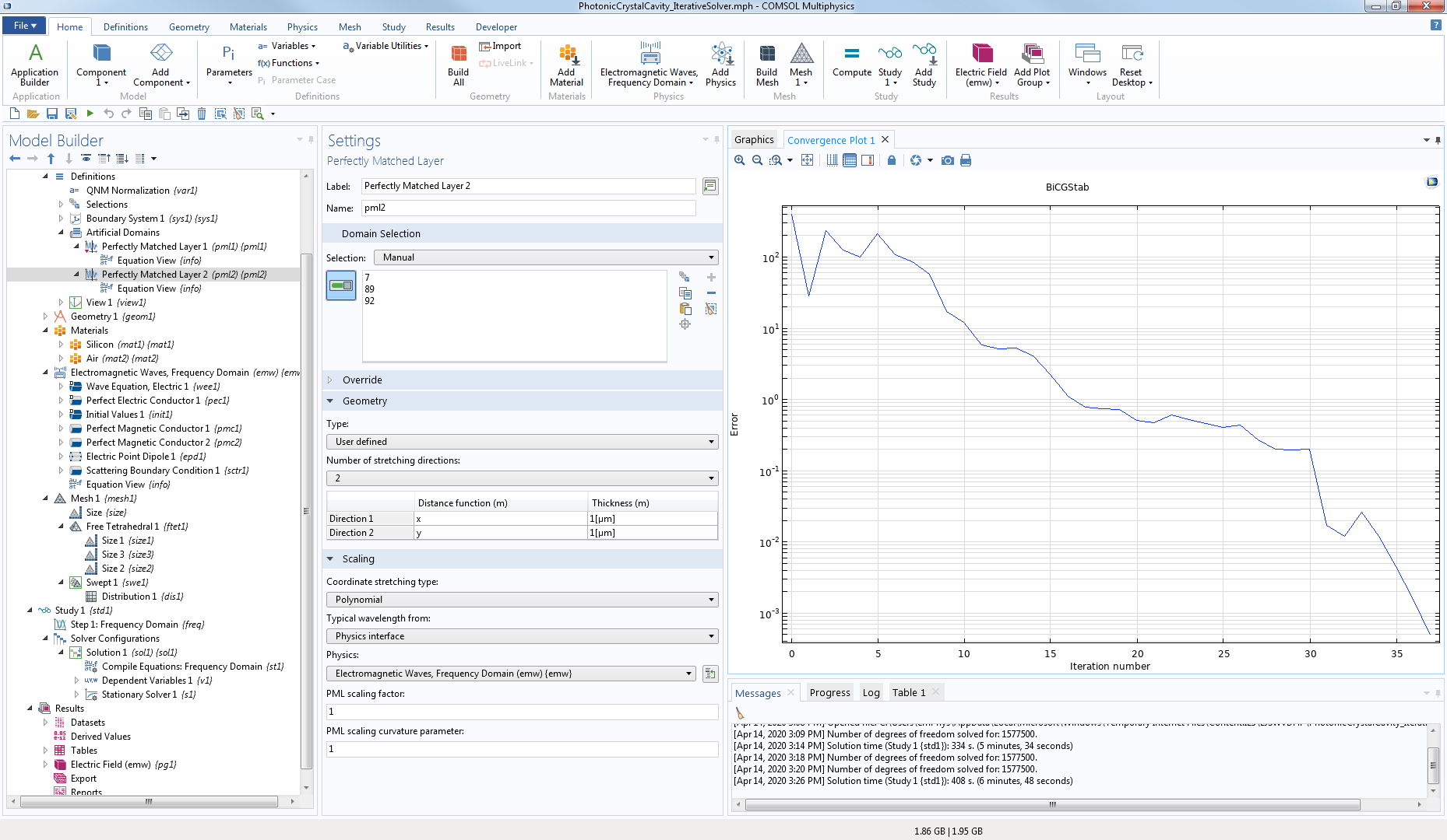

Guillermo,
PMLs should have homogeneous material parameters which is not the case in your model. I tried to set up a second PML only for the silicon parts with user defined stretching only in x- and y-direction as z is probably irrelevant in this domain. It converges then with the default iterative solver. It converges also with a cartesian PML in the silicon, but slower.
I did these tests in the current version 5.5, because I don't have 5.1 installed anymore.
You should carefully check if those PMLs work as expected.
