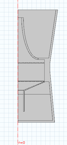

I am in a student group that is trying to simulate making coffee in a moka pot with a simplified geometry (shown in image). We are trying to get the volume of air in the lower reservoir to expand and force the fixed volume of water through the porous media (the coffee) and into the upper reservoir. We are leaving out the extraction of coffee entirely at the moment and are focusing on flow and heat.
