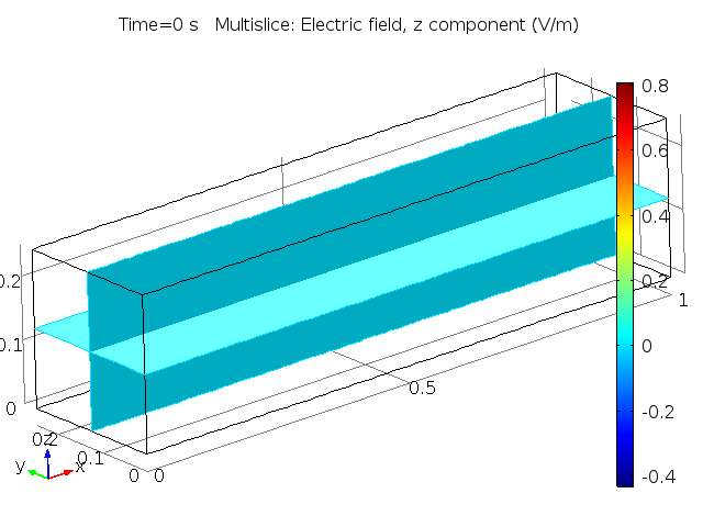

For such a time-domain model, I suggest using the time-domain formulation and launching a wave directly from a model boundary. I've attached an example .mph file (model without the solution, to keep the file small enough) along with a .gif animation obtained from the solved model, showing the pulse (which I chose to be an exponentially-damped sinewave) propagating along. I hope this helps. Note: you may need finer steps and/or a finer mesh than in this example, to do it well.

Posted: 9 years ago 2016/06/02 4:55 JST
Sorry, I don't have version 5.0 installed and I don't see anything like an "export into 5.0 compatible" option.
Note to other readers: Any suggestions?
Meanwhile, below is the text from an exported .java file which may help you understand what I did. ( I understand that it may be possible to turn such listings into readable models, but I don't know the details. I saw some info about doing that at: www.comsol.com/community/forums/general/thread/46901 .) Good luck.
* Pulsed_planewave_in_block_without_solution.java
