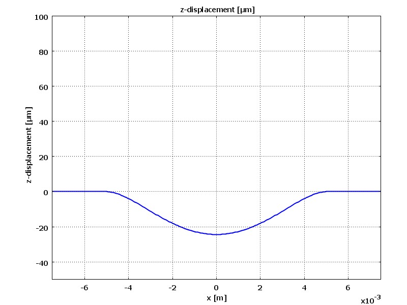

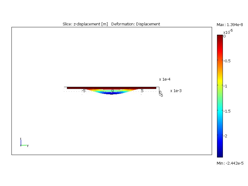

I took a line plot (XZ) on the lower surface and the value I get match the values on the colorbar. However, limited values of 'w' do not seem to change the 3D/2D display plots. I'm using version 3.4.

By comparing your two jpg I see the same value !,
your sag is negatif so its in the "blue" lower part of the color bar that you have -2.4e-5=-25e-6=-25um.
I have been cought a couple of times expecting to read on the top and not from the bottom, is it simply that ?
By the way you can always have your 3D graphs in um too, you have the choice of the units, just underneath the variable in the postprocessing plot window
