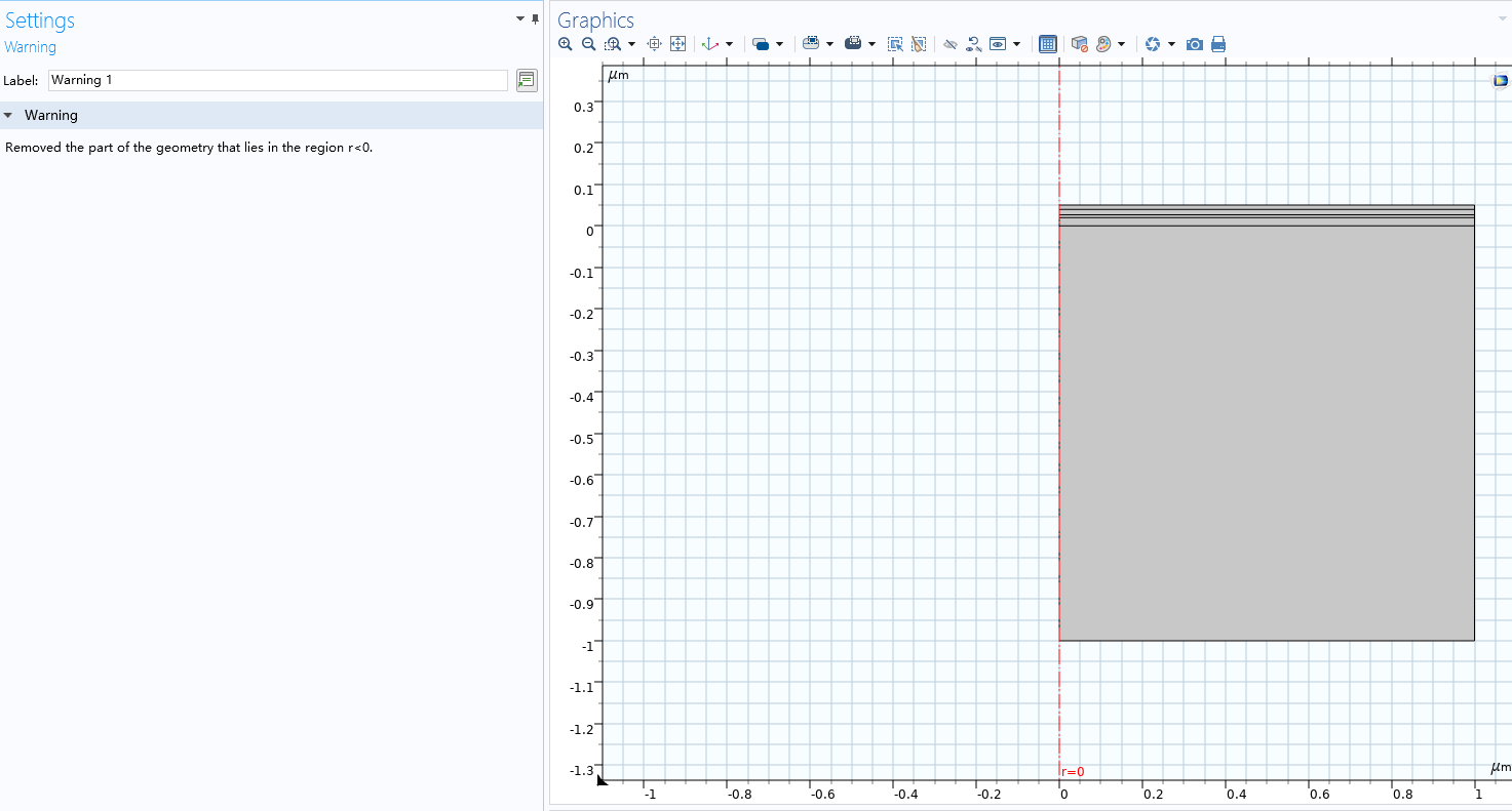

I met a problem by forming an union: when I try to form a union, half of the geometry is removed (2D model, r<0 is removed, axis symmetric), what should I do for this ?

Erfu,
This is because you are using 2D Axisymmetruc geometry, which cannot have any objects to the left of axial symmetry axis.
For 2D geometry, geometrical objects can be placed at x<0.
