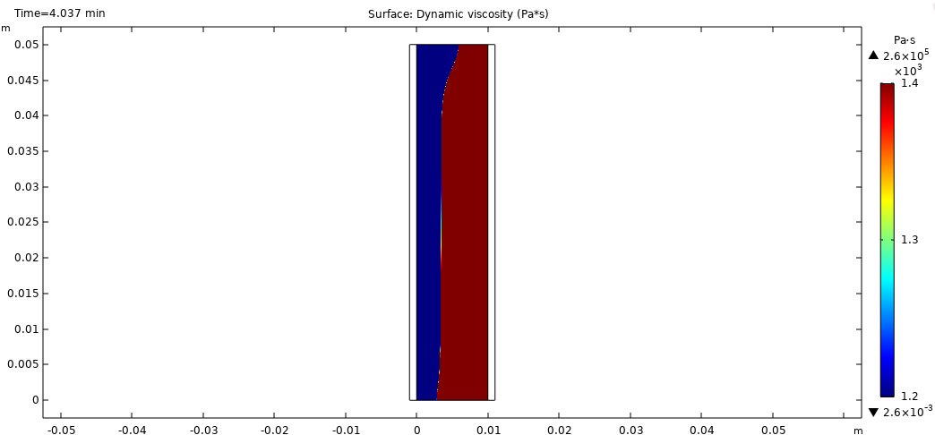

I want to calculate the ratio of blue area over the red area. How is it possible to get the surface area of this kind of plots from results.

You can use the integration tools available under Derived Values. For the expression to integrate, specify a boolean expression along the lines of
quantity>cutoff_value1
or
quantity<cutoff_value2
PS: If you even want COMSOL to compute the ratio of the two integrals without having to pull out your calculator, you can instead define a Nonlinear Coupling (found under Definitions in the model tree) of the integration type. If it's the first one in your model it will be called intop1 and in derived values you'd ask COMSOL to return, in essence, intop1(quantity>cutoff_value1)/intop1(quantity<cutoff_value2)
