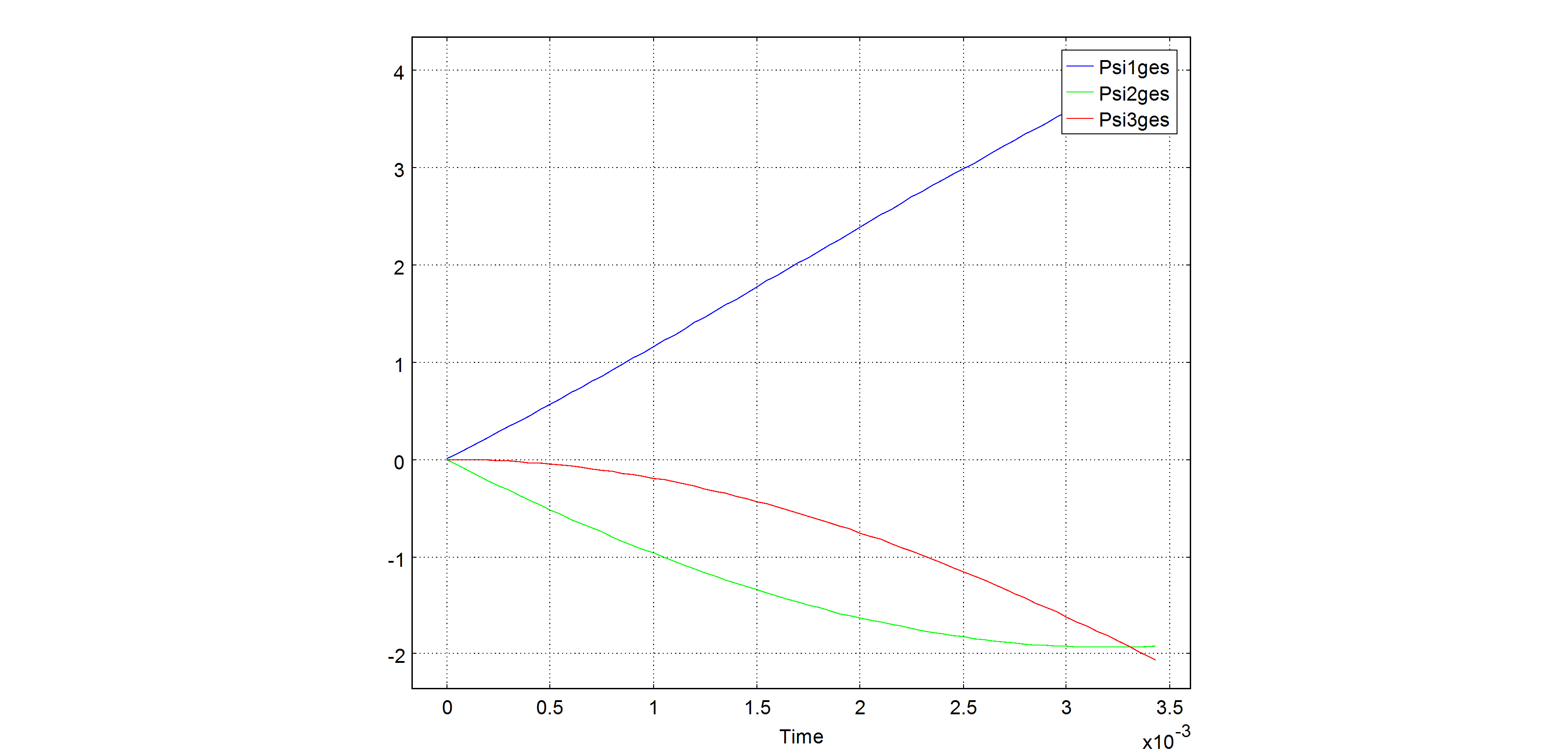

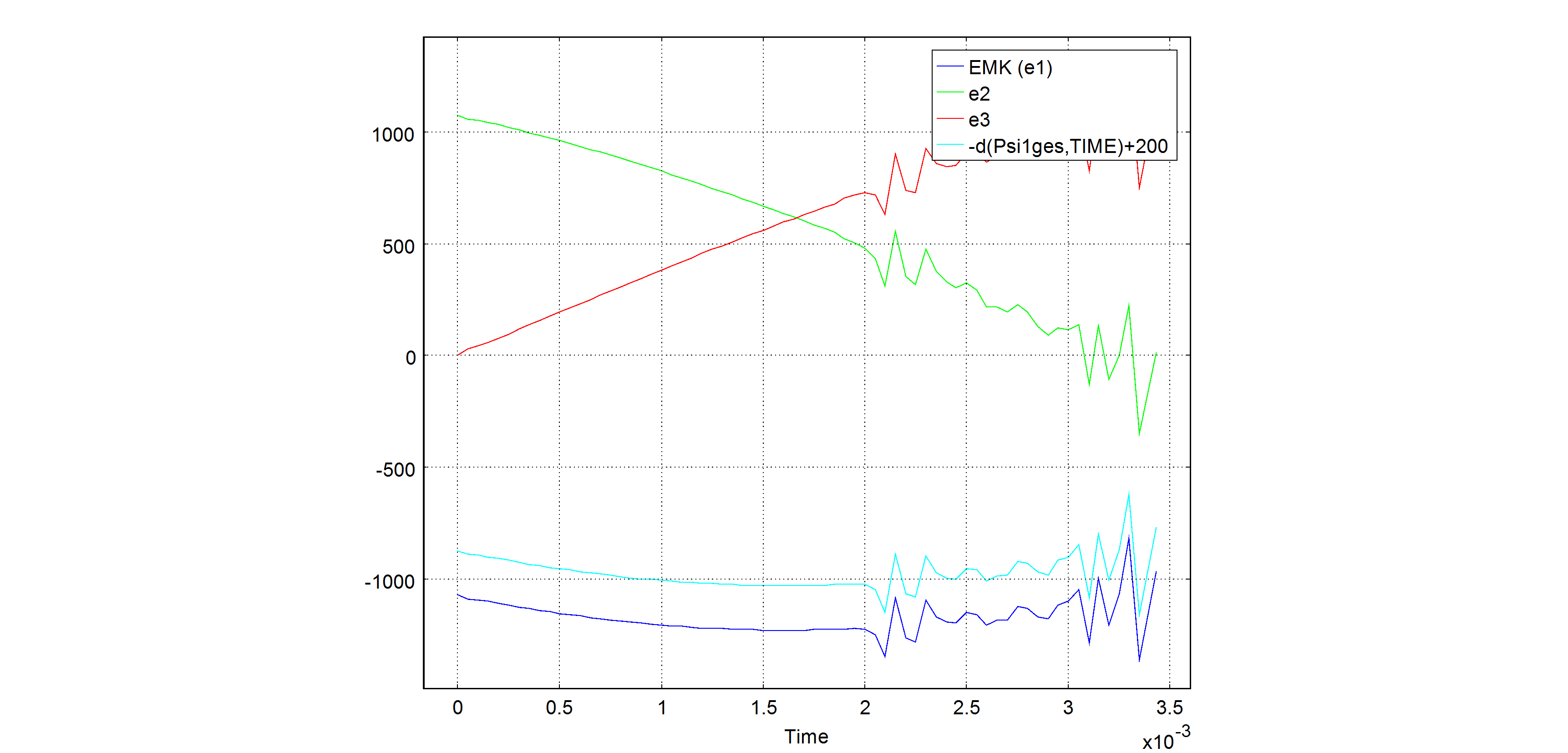

My problem is that the model won't solve when the permeability is non linear. Interesting is that after 2ms the simulation becomes very unstable and won't get to the 10ms mark.

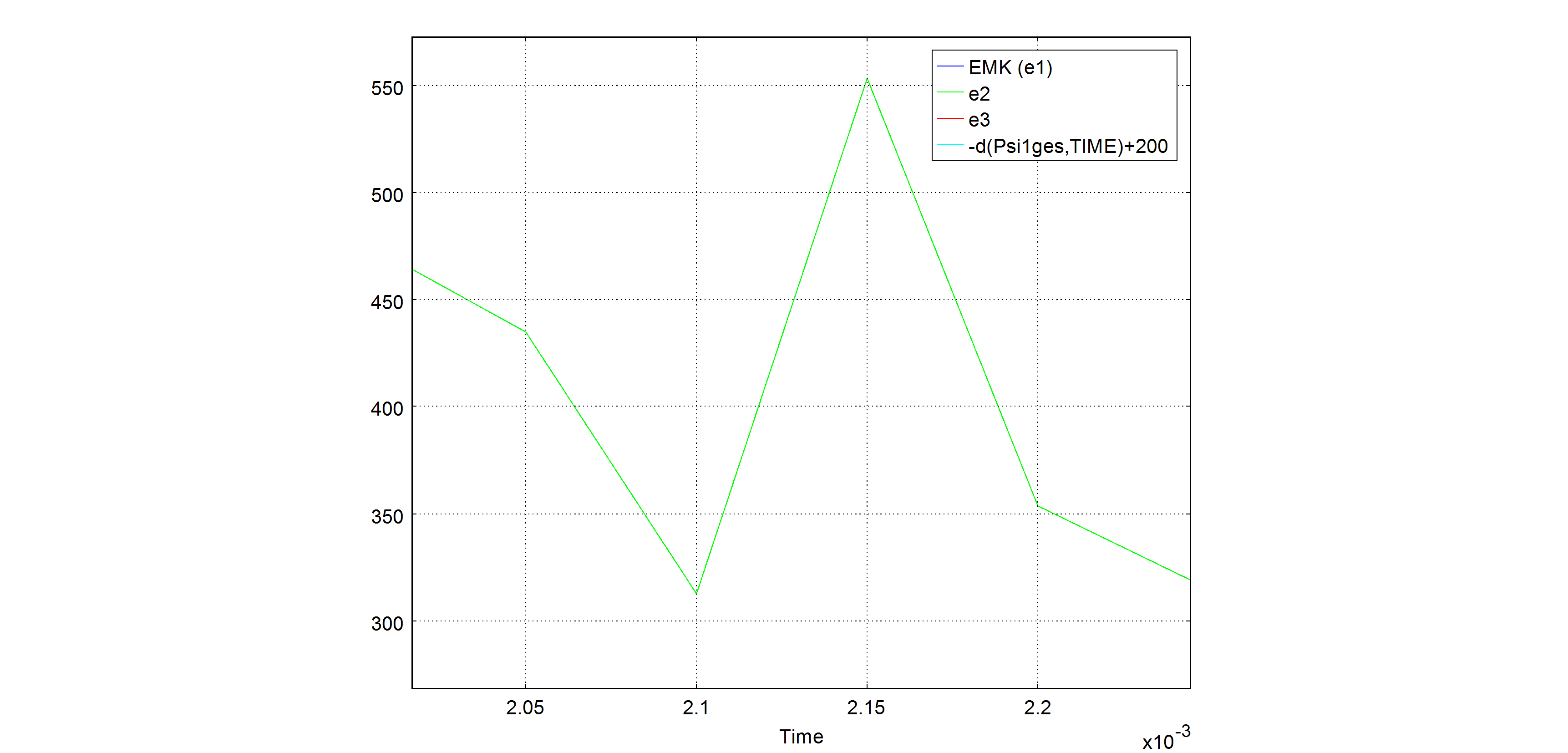

In the attached pictures I want to show how unstable the time derivation of the flux linkage suddenly becomes.
You have an overview there and zoomed pictures.
Is it somehow possible to damp that derivation a litte? I'm afraid that this is causing my simulation to become unstable. Could it be that Comsol by default changes something at ca. 2ms that affects the derivation?
