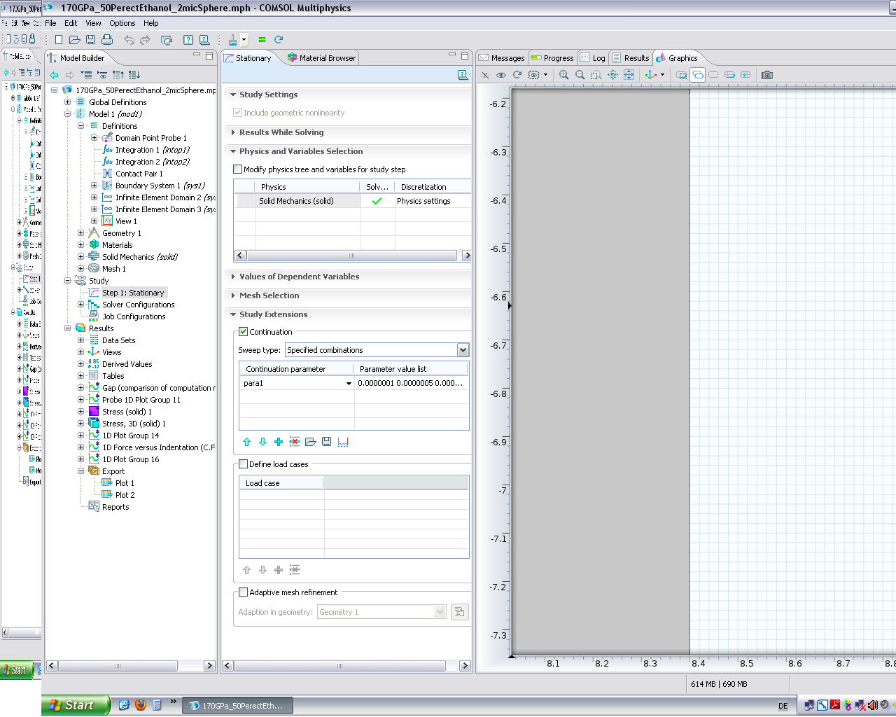

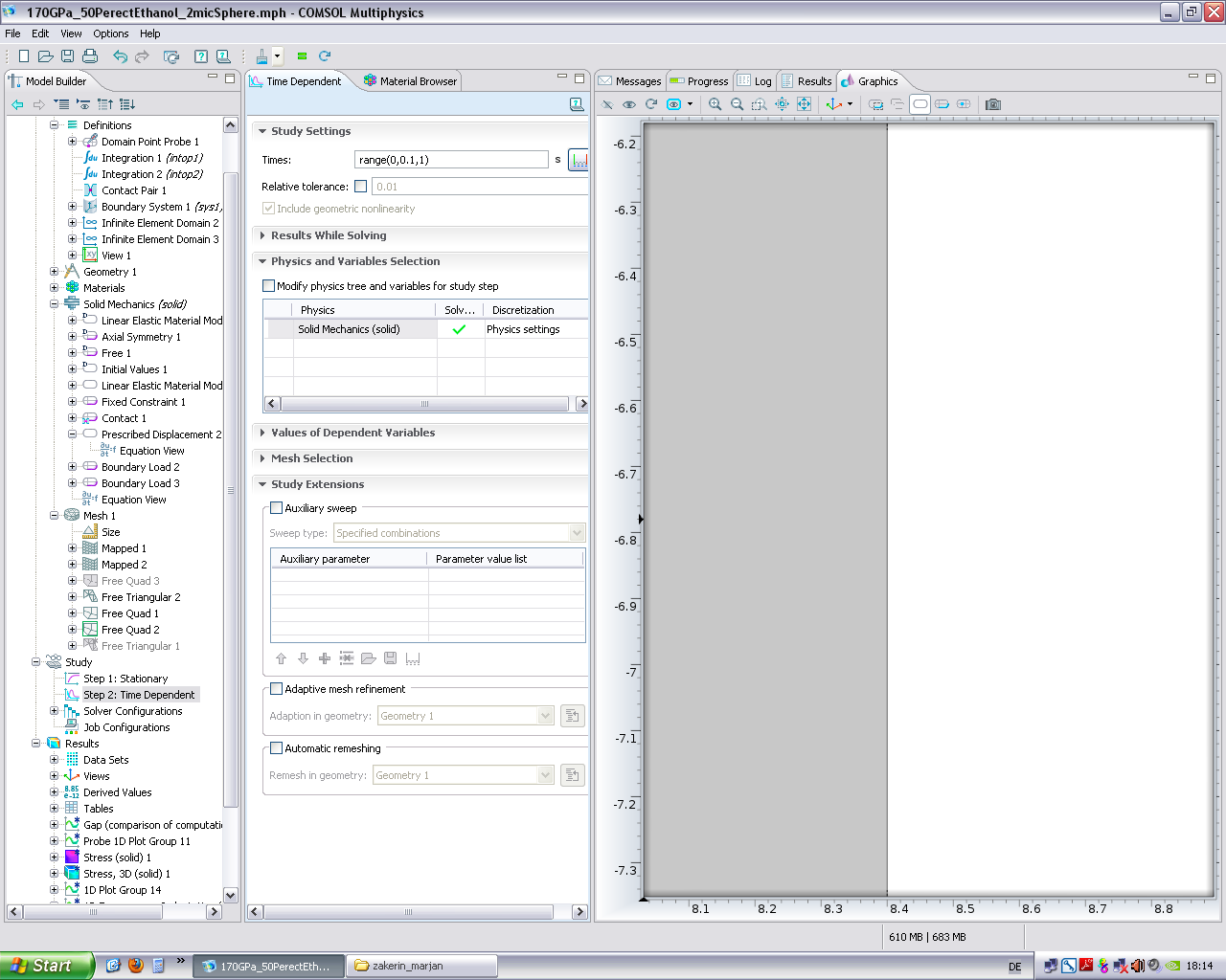

You can give values to " t" in continuation of parametric sweep. Use continuation. Please see the attached file. The second point is check that size of your mesh elements on the PMMA is 1.5 times smaller than the mesh size of your sphere. Check 2 times as well.

What is the theory you want to compare your simulations with? I used Hertz model. As it is a model for half infinite surface, I used infinite element domains in definition part of comsol (see the attached file please) and decreased the number of mesh elements a lot. But my support is divided to several domains . The model became also very exact. It is as if you had a half space surface.
I did the reverse of what you did. I controlled displacement and with week constraints, I calculated reaction forces. Do you want to see the indentation? It is also interesting :).

..... See the attached new file for the continuation time dependent solver
Marjan
..... See the attached new file for the continuation time dependent solver -- Marjan
