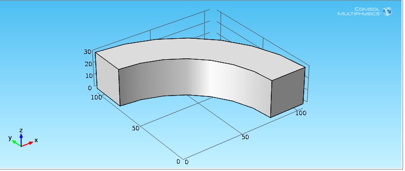

I am Akshay, a student of Mechanical Engineering. I am using COMSOL 4.2 for my research in Microfluidics, and am currently working on the numerical simulation of a purely Electro-osmotic flow in a curved channel, that is a quadrant of an annulus between 2 cylinders. The flow simulations for my research require the streamline contours of the flow in the cross section of the channel. But I am right now able to plot the streamlines only along the axial path of the channel, that is along the circumference. Although I am getting the results correct, they are of a lesser importance to me, since I need to capture the formation of flow circulations in the c/s of the channel.

For your referenc,e I am attaching the image of the geometry file herewith.
Thanks again,
Akshay
