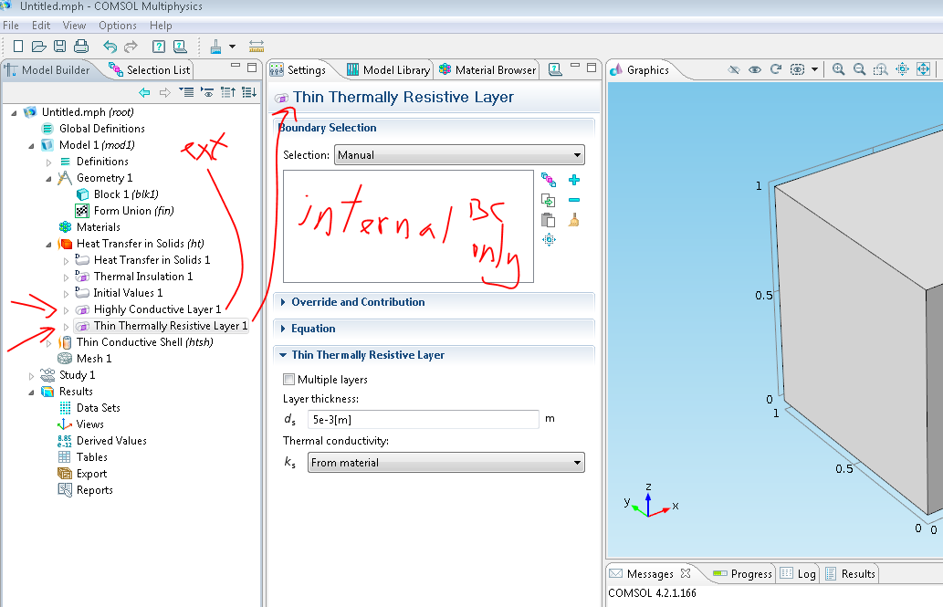

The thin thermally resistive layer adds a temperature step along the normal of the boundary.
The thin highly conductive layer adds a thin layer that conduct along the boundary
careful not to add both to a common (union) boundary, my version fails with an error
If you are using assembly mode, then note that the pair continuity, pair thin thermally resistive layer, pair highly conductive layer can all be added but they interfer, and from my understanding only one should be enbled at each time
Hi its my typo I do not believe it has changed with the version (I have 4.2a .166) The thin thermally resistive layer adds a temperature step along the normal of the boundary. The thin highly conductive layer adds a thin layer that conduct along the boundary careful not to add both to a common (union) boundary, my version fails with an error If you are using assembly mode, then note that the pair continuity, pair thin thermally resistive layer, pair highly conductive layer can all be added but they interfer, and from my understanding only one should be enbled at each time -- Good luck Ivar

Does anyone know if there is any way model a thermally resistive layer with a tangential conduction? I know the equation only as a normal component, and as Ivar said, it cannot be used in parallel with highly conductive layer. WIth only the normal component, it does not react to the gradient applied in the tangential direction.
