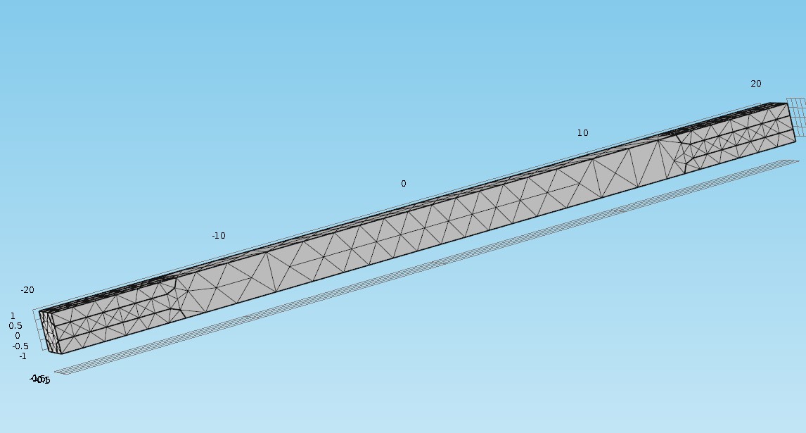

I am trying to mesh a structure. I have a block and objects inside that block. The blocks gets meshed insanly coarse, while the objects inside get meshed rather fine. The block has elements that are in the size of it's diameter, this just cannot be. Where do I make a mistake.

I used "Scale" if this is was you ment by "Scale variable". I managed to make the mesh finer by using small values (values larger than 1 only made the mesh coarser). Still my external program says me that the mesh does not fill the volume. Also the mesh starts to look very ugly (Extremly fine in places it does not need to be fine).
Did I misunderstand what you meant by "Scale variable"?
If not, how else can I prevent this mesh from getting broken, how can Comsol realise it has to mesh coarser in the middle of the bar.

Hi i guess this is what you wanted .. hopefully i am right !!
the objects inside cube are symmetric and the elements are coarser on the main cube !

Thanks for your attempts to help me. The mesh of the structure you sent me seems to be correct. The problem is that I need a symetric mesh. I will subject this mesh to periodic boundary conditions. Every node on the surface has to be symetric with a node on the opposite side. By opposite side I mean a node in an XY plane has another node in the XY plane on the other side of the object, with identical XY coordinates, just differing in the z value. A node in the YZ plane has another node with identical YZ coordinates, just a different X coordinates and so on.
However thank you for what you sent me. I have a mesh that is symetric but broken, and you sent me a mesh that is not completly symetric but not broken, I will try to combine both together to get a symetric not broken mesh.

Its simple ... ' I have got an idea .. if u need symmetric mesh just divide the object into 4 by cutting it using two planes .. then mesh one volume and copy the same thing to the other four ... ! ..
first do what i did to the one fourth geometry and then copy domains ... !

While I was trying it out I realized that restricting the maximum element size also solves the problem, thanks for your efforts to help me.
