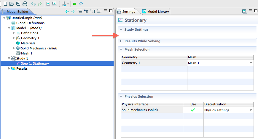

I have an odd problem. I am trying to recreate the Large Deformation Beam model (www.comsol.com/showroom/documentation/model/204/) before I start my own project to investigate buckling. I was following along with the model, but when I go to Study 1 > Step 1: Stationary and open Study Settings, I do not see any buttons that say "Include Geometric Nonlinearity". Indeed, I do not see any buttons at all.

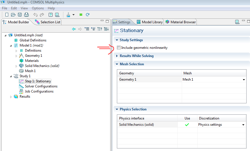

When I download the support file for the Large Deformation Beam model, I do see this button.
However, if I delete the stationary solver and add a new one, I do not see the button any more.
It seems like I must be doing something dumb here, but I can't seem to figure out what. Any help would be appreciated.

Posted: 1 decade ago 2012/02/04 1:13 JST
I do (if I select solid, it depends on the physics (also .166 on Win-7)
Hi I do (if I select solid, it depends on the physics (also .166 on Win-7) -- Good luck Ivar
Posted: 1 decade ago 2012/02/04 1:39 JST
I don't (even when I select solid, on a Mac)
-jfb
Hi I don't (even when I select solid, on a Mac) -jfb
