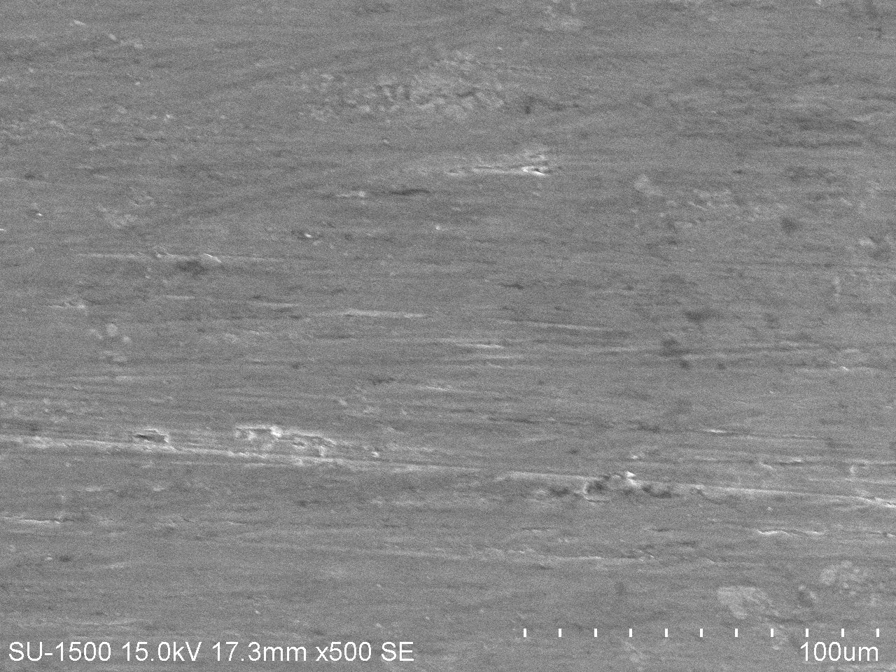

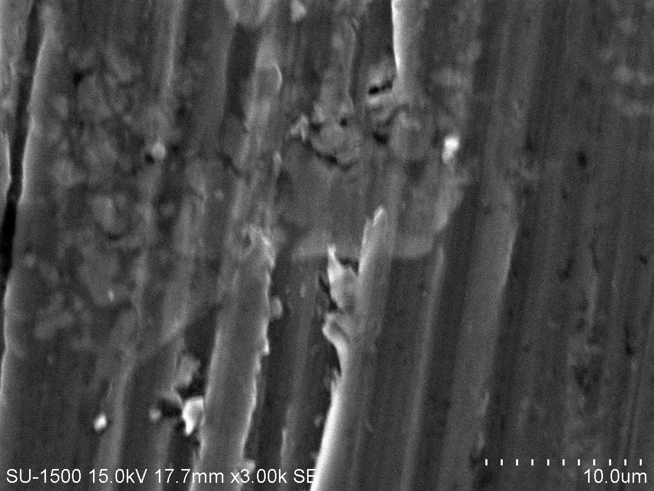

Hi I have SEM report which is in jpg format these image has to be imported to the comsol so that i have to define material . it is a composite of two material, i am finding thermal residual stress on it,,please tell me how to proceed. and how i can change the temparature parameter.
Posted: 1 decade ago 2015/04/21 6:20 GMT-4
files are attaached
Hi I have SEM report which is in jpg format these image has to be imported to the comsol so that i have to define material . it is a composite of two material, i am finding thermal residual stress on it,,please tell me how to proceed. and how i can change the temparature parameter. files are attaached
Posted: 1 decade ago 2015/04/21 7:51 GMT-4
You can define an Image function and use the value from it when setting up your physics.
