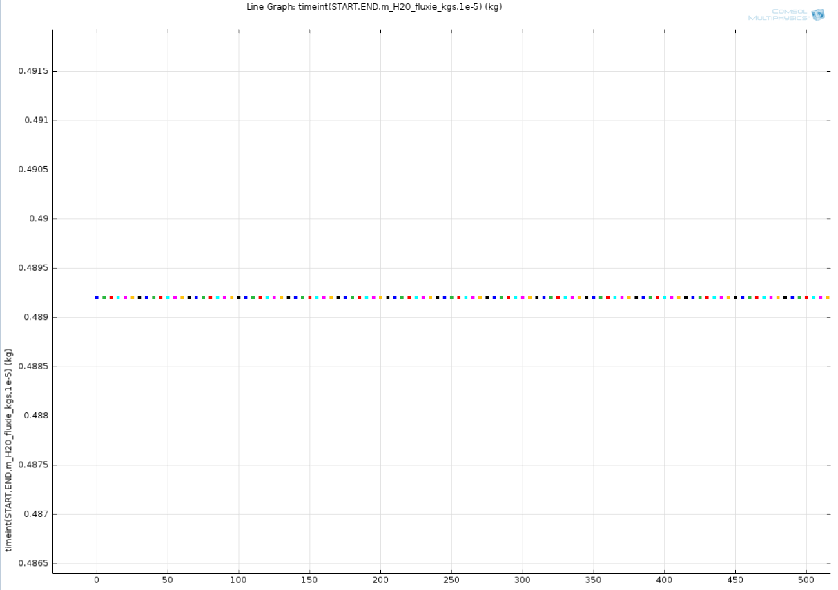

The situation is that I have a tube (L=1m) with a porous medium in it and air flows in and out again and at the same time water is being evaporated from the porous solid phase to the gas phase. This 1D model uses "Species Transport In Porous Media" and "Darcy's Law". The first one calculates the concentrations, the second one gives the species mass and calculates the density and velocity. The 'drying' is modeled using a mass source of H2O that is dependent on temperature and the amount of water left (first order Arrhenius type equation). These I modeled myself and seem to be fine.
The problem is that I want to make a mass balance over the reactor. So, the time integral over all mass that flows in + the time integral over all mass that is released from a source term into the gas phase, is equal to the time integral over all mass that flows out at the exit. When the temperature is constant, this seems to be true with an 0.5% error, which is quite ok, but if the temperature changes over time (simulated using a step function) the difference in the time integral over what goes in and out is more than 50% off!! And so is the integral over the source flux, it is ridiculous. I may be doing something wrong here, but I have no idea what. Can anyone please help me?
I have included the file. It is not as complicated as it may seem. Just O2 and N2 (air) flow in without doing anything and there is 1 kg of water available for release. No water flows in, so the end point should 'see' 1kg of water come by over time. However, according to the timeint function the answer is 0.49 kg.. same for the integrated source flux.
Things I already tried:
1) Increasing the accuracy of the timeint function ( timeint(START,END,dl.rho*dl.u*A_flowthrough,1e-10) )
(1e-8 is standard), usually I use 1e-5 since it doesn't matter much and takes a lot longer to calculate).
2) fiddling around with the time stepping. Tried all kinds of settings, it converges well now, but still no good answer.
3) Changed Tolerances: Abstol is now 1e-3, Reltol is now 1e-8, quite okay I think.
4) Conservative vs Non-conservative formulation (compressible vs incompressible gas), does not matter much.
5) Changed amount of elements, currently 2000, just to be sure. But increasing # elements does not help.
6) Changed discretization order from Quadratic to Quartic and back again, no effect.
It must have something to do with temperature, because it did work when T was constant and now it doesn't since T is a function. Included in this post is the actual model (4.2a) and some graphs.

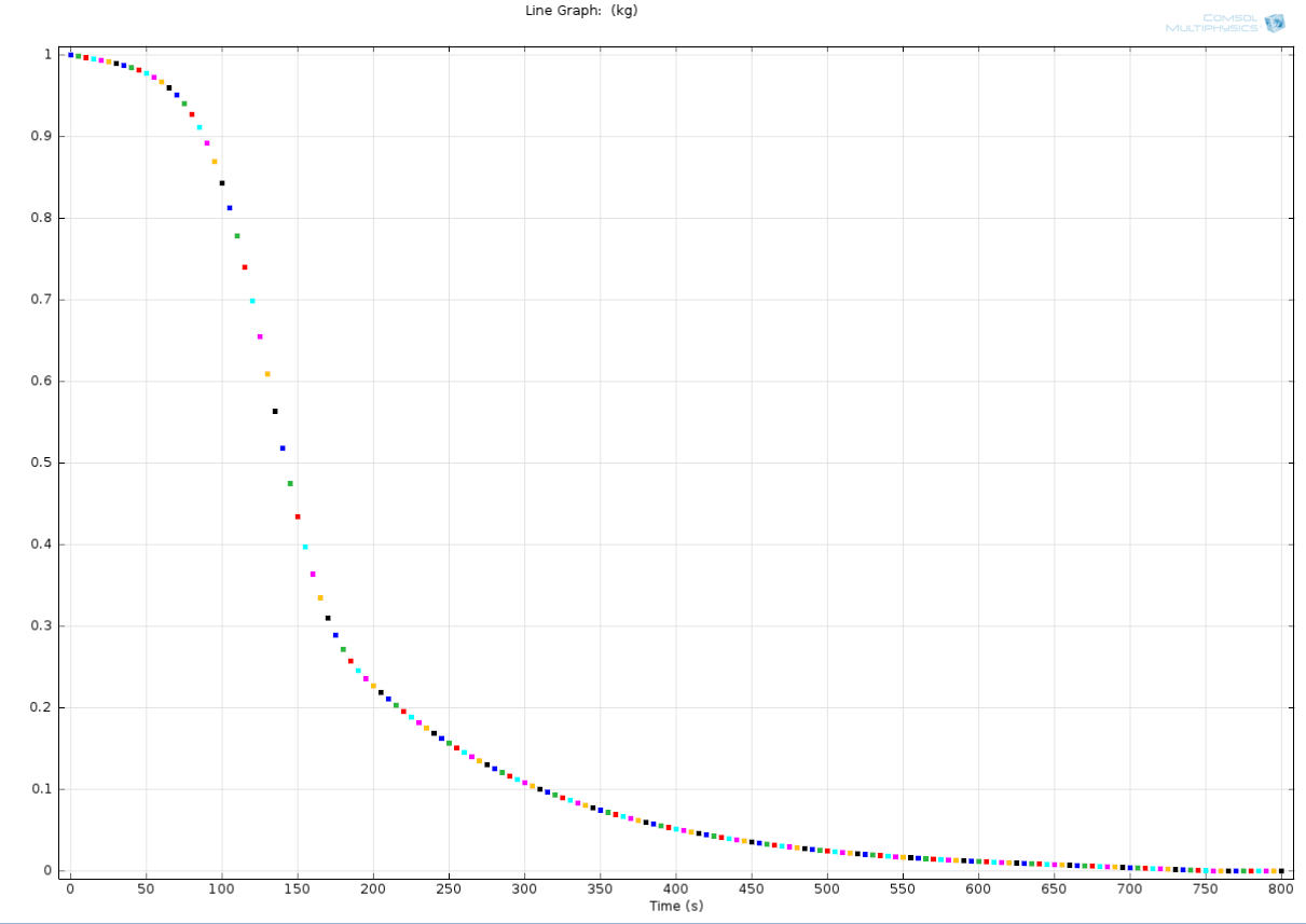

The first graph shows my own calculation of the amount of water left in the solid, this goes to 0, like it should.
The second one show the time integral over the exit and this is 0.49 kg while it should be 1 kg.

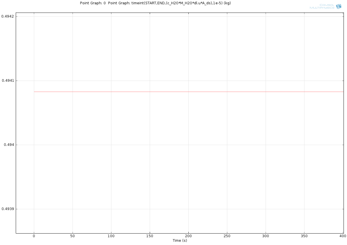

The third has the same problem.

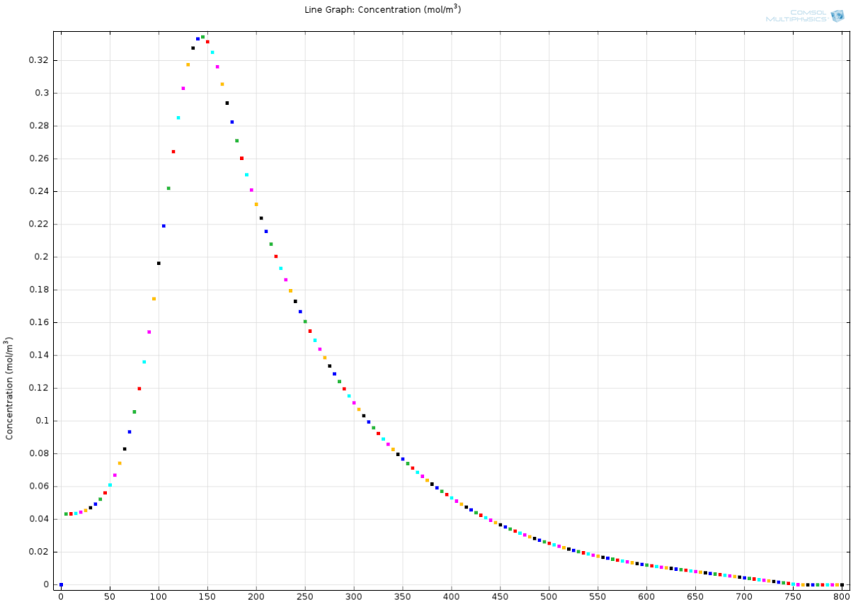

The last one shows the H2O concentration in the entire reactor vs time. Most important is that is goes to zero, so apparently all mass flows out of the reactor.
I would be very happy with any useful input! Thanks in advance!
