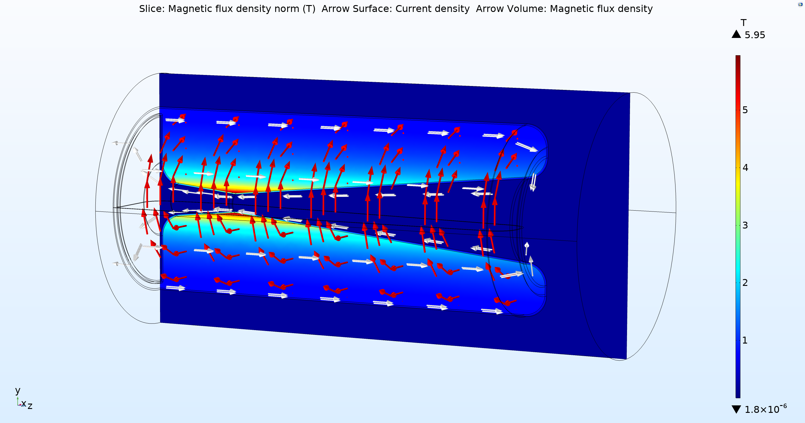

                                                    Hi Edgar,
The idea of the coaxial port seems the right way in this case, however:
1- Option "Coaxial" of the "Type of lumped port:" is not available for any of the AC/DC module physics nodes!! I am using "Magnetic field (mf)".
2- While it is different physics, I tried to guid myself abit with this example, to understand how the lumped port works. So, I defined the input and output ports (with terminal type = current), please see the attachment. However, this gave me non-understandable results.
3- I also tried to assign the terminal between the two conductors as you suggested, but still the solution is not correct.
Just for guidness, I also attach the corresponding/correct/expected result from the 3D model!
Any advice!
Tamer

                                                    Hi Edgar,
Modifying the input parameters of the mf physics to solve in-plane helped indeed to activate the coaxil option.
Now, solving the model without adding any further boundary conditions, than Port 3, gives me the "The relative residual (1.1e+49) is greater than the relative tolerance." error message!! Indication of a huge problem either in the:
- defined boudary condition ==> I reduced the applied current to very low level.
- or meshing startegy ==> I modifed my meshing to a very efficient boundary layers style.
- I also tried to change the direct solver to PARDISO.
- I also treid to change the termination process depending on a large number of iterations.
What I am still missing? The modified model is attached.
  Tamer

                                                    Dear Edgar,
Many thanks for your guidance throughout this case. It works perfect now.
As usual and in order to close this case in a useful way, I attach the working model as a reference for the future similar cases. I also want to state that the Gauge Fixing node was not making any difference for this specific model. However, as Edgar recommended, always check its infuence for each specific case.
