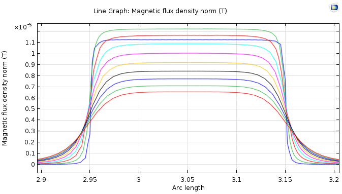

hello, I use COMSOL for a short time and want to know how I can display the maximum and minimum values a curve in the table. I thank you in advance

You can calculate maximum and minimum values by right clicking the Derived Values node in the results section.
