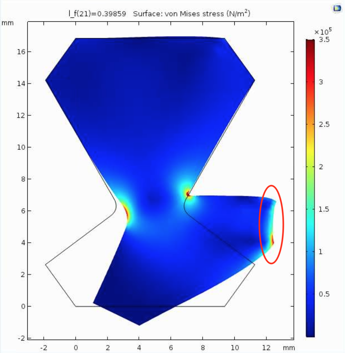

I am attempting to model a flexure hinge subject to bending (see attached picture and model) using the Solid Mechanics module with a stationary study and have run into convergence issues.
For the simulation, I am using an auxiliary sweep with a ramped displacement applied to the bottom right face of the flexure hinge (circled in red on the von_Mises_Flexure_Hinge photo). The issue I am having is the simulation fails to converge around a displacement of 4mm, which corresponds to the deformed shape in the von_Mises_Flexure_Hinge photo. Ideally I would like to be able to model the deformation until their is contact between the two faces on the compression side of the flexure hinge.

  • Material: Silicone rubber modeled as neo-hookean (Material Parameters: incompressible, mu = 0.27e6 (Pa), Bulk Modulus 13.4e6 (Pa), and Density 965 kg/m^3.)
  • Plane Stress: Thickness 3cm and Quasi-Static.
  • Fixed at the top right and left boundaries.
  • Prescribed vertical displacement at bottom right boundary.
  • Including geometric nonlinearity, auxiliary sweep (0.02 step) to 0-1 cm displacement, predictor: constant, fully coupled.
