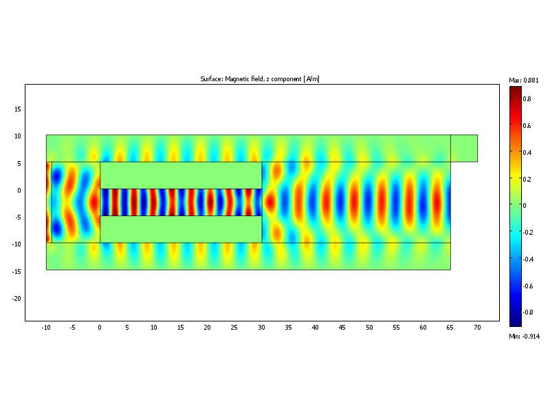

After simulation I got this.. But why is the light entering the dielectric in between. Should it not be like this?
img546.imageshack.us/img546/3599/poog.png
Thank you for the help
You should rather upload the images on the forum as not all of us have access to all external load servers
Then I could take a look at it.
Also even so Comsol Support is sometimes a bit slow, it is always worth sending them an email as well, they are usually pretty helpful.
This is the one given by my professor
www.mediafire.com/?tk4aqul5yt4ey9e
This is the one that I tried to simulate
www.mediafire.com/?a5h3js03u6gpy8q
I want to know why the light penetrates the dielectric surface when the plasmons are supposed to travel at the interface alone
1. Could you please use the upload function of this forum? And not upload the files somewhere else?
2. Instead of using the report, could you just upload the .mph file itself? (Clear Mesh & Solutions)
-Niklas
1. Mesh finer (refine mesh 1-2 times)
2. At the same time reduce the size of the simulation domain where you do not need it.
3. I am not sure about your scales, but from my feeling you dimensions with respect to the wavelength are off. The wavelength should be larger or the dimensions smaller, not sure what you are trying to do with this model? Is this a real physical system you are trying to model?
Doing this, I get some results (see file in the attachment).
Let me know if this is what you are looking for?
Also it seems the file problems you were having were related to firefox? I just had a similar problem, where attaching a file did not work with firefox, but the same file was okay with internet explorer....
