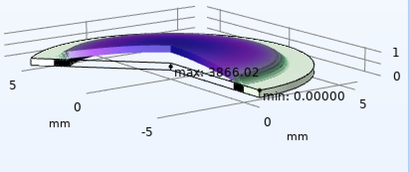

                                                    That is strange, because when i plot the maximum and minimum displacement, is around 3 meters in the positive z direction, and I would expect the movement to be in the negative z direction. I have attached an image of my results.
Thank you again for your time,
Marc
Marc

                                                    Hi Marc,
I don't have the software here to open your file, but I am going to guess that you're looking at modes, so that magnitude and orientation have no meaning.
    Jeff Hiller
                            Hi Marc,

                                                    I only ran the static analysis, which makes perfect sense. The weird things are in the linear buckling analysis, which I have not had occasion to use.
