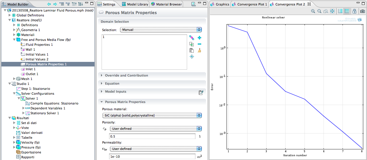

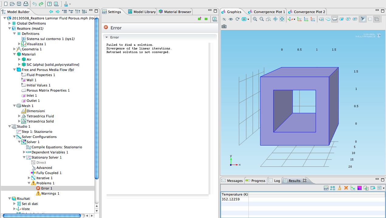

Also my solver doesn't converge (Image attached) with this physics.
The error message is:
"Failed to find a solution.
Divergence of the linear iterations.
Returned solution is not converged."
My problem is to simulate the flow of air through a square channel and a porous solid (SiC).
I'm trying to use the physic "Free and Porous Media Flow" (Domain: All)
- Fluid Properties (Domain: All, pressure fp/fp1)
- Porous Matrix Properties (Domain: 1, Porous Material SiC, Porosity 0.5, Permeability e-10)
- Inlet (5m/s)
- Outlet (P=0)
- Initial value (P=0 u=0)
Are these settings and boundary conditions correct?
Also my solver doesn't converge (Image attached) with this physics. The error message is: "Failed to find a solution. Divergence of the linear iterations. Returned solution is not converged." My problem is to simulate the flow of air through a square channel and a porous solid (SiC). I'm trying to use the physic "Free and Porous Media Flow" (Domain: All) - Fluid Properties (Domain: All, pressure fp/fp1) - Porous Matrix Properties (Domain: 1, Porous Material SiC, Porosity 0.5, Permeability e-10) - Inlet (5m/s) - Outlet (P=0) - Initial value (P=0 u=0) Are these settings and boundary conditions correct?

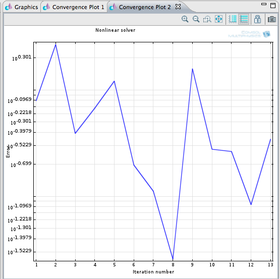

for diffusion equations it's often the intial conditions (default all =0) that are too far from the solution for the solver to converge. try to initiate flow and diffusion equations in the initial conditions, or try running a steady state with low flow velocity and ramp up any flow with a parametric sweep or over the first seconds/hours of yout time/transient simualtion
Hi for diffusion equations it's often the intial conditions (default all =0) that are too far from the solution for the solver to converge. try to initiate flow and diffusion equations in the initial conditions, or try running a steady state with low flow velocity and ramp up any flow with a parametric sweep or over the first seconds/hours of yout time/transient simualtion -- Good luck Ivar

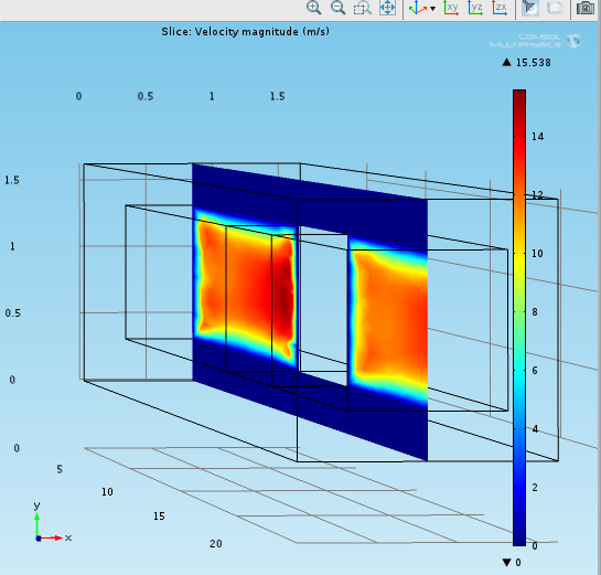

I initialize the flow with a velocity as 0.1 in the axial direction as you suggested to me and it works with a permeability of 1e-10 m2 (Permeability_1e-10.png.png)
In every way the velocity slices don't show flow in the porous media around the open channel. (velocity_Permeability_1e-10.png)

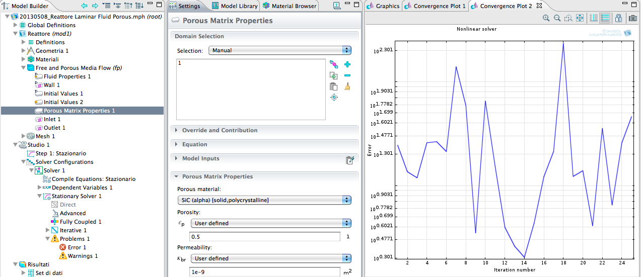

First of all I tried to change the permeability, but as I increase it the system doesn't converge (Permeability_1e-9.png).

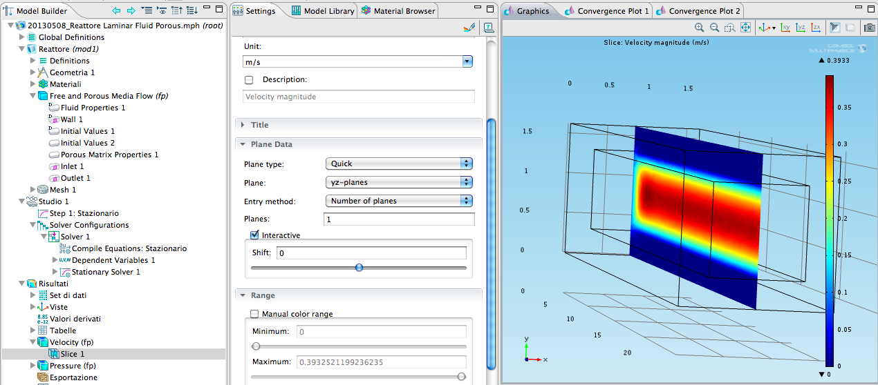

My second solution was to insert a solid cubic obstacle in the free channel to force the fluid to go through the porous media. As the fluid approaches the obstacle the velocity goes to zero, but inexplicably v goes to zero in the porous wall to recover it's value after passing the cubic. (Cubic obstacle.png)
How is it physically possible?
What is wrong with my settings?

When I am using the "free and porous flow" model, I also sometimes have results where the velocity is zero within the porous media. However, when you look at the pressure, you see that there is a flow through the porous part because you can see a pressure drop over this area. I dont know how this is possible in the equation (since pressure is linked to velocity) but it happens.
I found, that the reason for this problem is, for the most part, a coarse mesh. By refining the mesh, the velocity increases to a certain value. Interestingly, the pressure drop stays alsmost constant, so the calculation of the pressure does not really depend on the velocity within the porous part.
So I suppose you should try to use a finer mesh for the calculation to see if the reults change.
