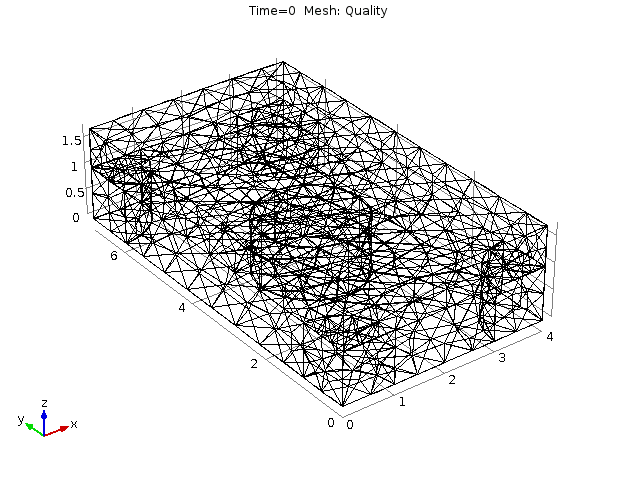

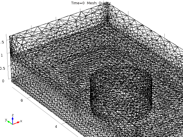

Another thing, since I have boundary elements around the cylinder for the fluid flow, the mesh element quality is inherently lower. So when I added automatic remeshing, I had to lower the minimum element quality to something like 0.03 (instead of the default 0.2) in order for the solver to work. Having fluid elements in transient moving mesh makes the solver very slow though... oh well. I have attached a gif file to show the moving mesh results, which took about an hour an 15 minutes to run.

I'm not astonised you need to lower the mesh uality, even "boundry mesh elements are often thin and long, and thend to lower te "quality" that from what I understand is a measure of the "roundness" or ability to enter perfectly with all external nodes onto a sphere. Another way is to mesh separately the cylinder with a rather fine mesh, and leave the external part ina coarser mode.
3D CFD is RAM and comuter intensive, so its rather nomal it takes time, getting worse when you mix in T too.

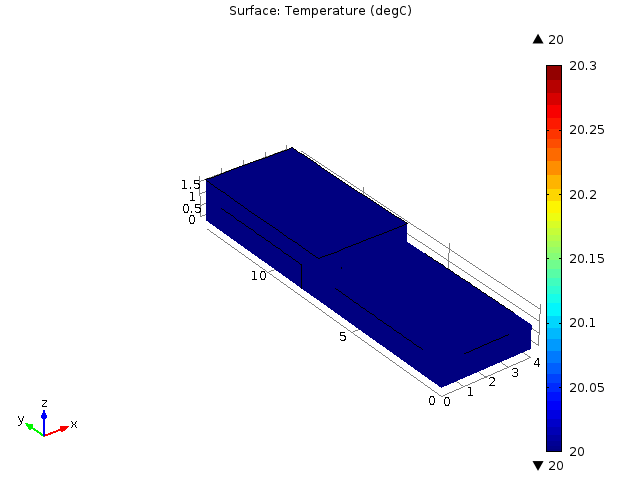

I did stationary laminar flow and then transient heat transfer + ale. The laminar flow worked fine (I did with and without the periodic boundaries you mentioned with a point pressure constraint). However, the heat transfer solution looked funny to me at the boundary heat source, and this brings me back to the issue of identity pairs again. I added a pair heat continuity (with the identity pair created in assembly mode) in addition to a heat boundary source that is only supposed to occur under the plate. The heat generation is supposed to be from friction, so it should only occur underneath the plate. From the solution, it seems the identity pair created (which is plate bottom + cylinder tops) still does not allow for heat continuity between the plate and the cylinders that weren't originally in contact with the plate. Secondly, the boundary heat source is only supposed to occur underneath the wafer; instead, the cylinders that were originally underneath the plate (but are no longer) still are generating heat.
My question is: what do I have wrong with my identity pair definition, or my boundary condition definition that is causing this odd thing to happen?

Indded it looks like that the heat is continuously transferred by the cylinders onto the fixed bulk block region, as the "imprinted" region is not moving, and even when the cylinders are far away (have you turned OFF the create imprint on the Finish Assembly node ? I would have tried)
Anyhow, you have an issue here when the cylinders leave the bulk Si you have a change in topology and the entities ID's are renumbered, with the risk that COMSOL misses the correct reconnection of the BC values. Ideally the bulk part should cover the full liquid range, but then you need to adapt the material properties with some Boolean values such that the material "vanishes" (almost totally) outside the region of the true bulk Si. In this way you have no geometrical transition region and no topology change hence no element renumbering. But probably you need to use the boolean variables also on conditionally changeing the BC for the heat transfer.
Tricky case, I feel somewhat short of ideas, hopefully someone else can give some tips too (and I'm not by my COMSOL WS so I cannot test anything out like that, just now ,)
