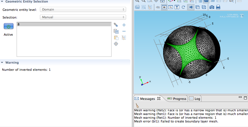

Posted: 1 decade ago 2014/07/30 18:13 GMT-4
Although I have a BS in chemical engineering and did quite well in mathematics, it was a while ago. With that said, I am completely clueless with many COMSOL error messages.
Although I do not consider my geometry that "complex," it does have some fine detail[photo]. As an example, there is a small gap between the parabolic surfaces, which were created with parametric equations. Before I ask my question about 'inverted,' I would like briefly discuss some of my problems with this relatively simple geometry.
Currently, I have a support ticket regarding the strange fact that COMSOL only extrudes my center[green in photo] as a solid when I minimize the extension of the parabolic surfaces beyond the cylinder. If I increase the extension of the parabolic surfaces to a certain point, all domains in the cylinder are extruded as solids. Therefore, it appears that the extrusion seems to be dependent upon the range of my parametric variable.
As far as meshing is concerned, I am having so many problems. I have tried to fix minimum element size through custom manipulation only to be told that, as one example, the edge is locked by adjacent geometry. I have no interest making the minimum element size of the adjacent geometry near 0.014 cm. Now, "inverted" has become a problem even though it did not appear as a problem in the past. Remember, I am a newbie. Sorry.
How do I fix an "inverted" problem?
