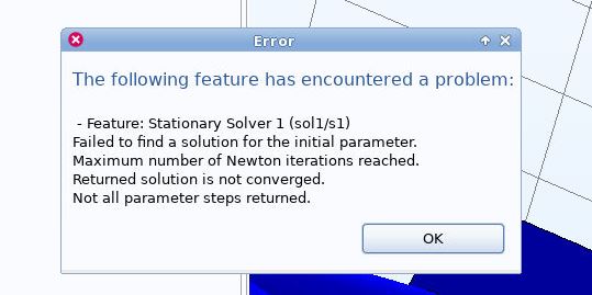

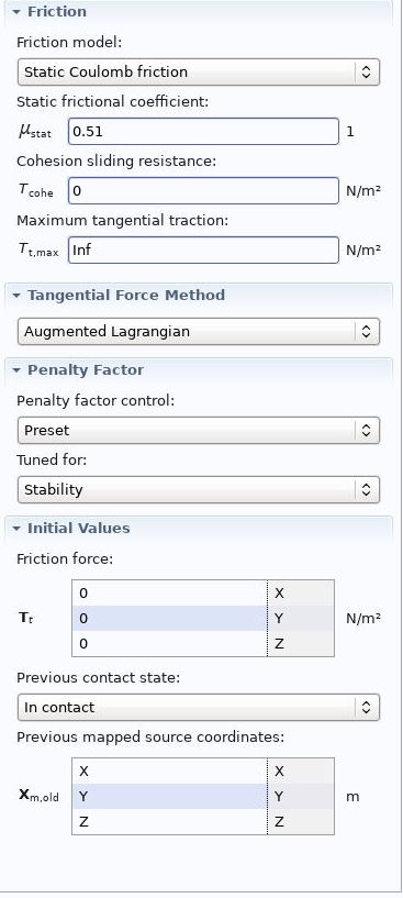

I am trying to model a Ti-alloy interlocked diamond in compression. As part of the model, I would like to add the friction between the diamond and a "steel plate", which I made into a rigid body to help with convergence. When I try to run the model with friction, I get the atttached error. I also attached a picture of how I set up the friction. Please let me know any additional information needed to help the model converge.

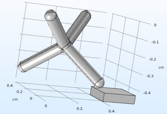

I wanted to add more information to better help with getting some ideas. I attached a picture of the model. There is a contact pair between the steel block and the alumide diamond. The steel block is a fixed rigid body.
The alumide interlocked diamond is fixed on the bottom leg that is not part of the contact pair. The top legs have a downward vertical displacement of 1 mm (~10% total length) applied as a ramp function in .04 increments from 0 to 1.
I have seen issues with both plasticity and friction; the friction will not initialize, and the plasticity seems to fail once it enters the yield stress. I know both the friction and plasticity functions have a decent amount of non-linearities. Are there any suggestions to get the model to approach convergence? The model will converge if neither friction nor plasticity are implemented.
Thanks! Danny
