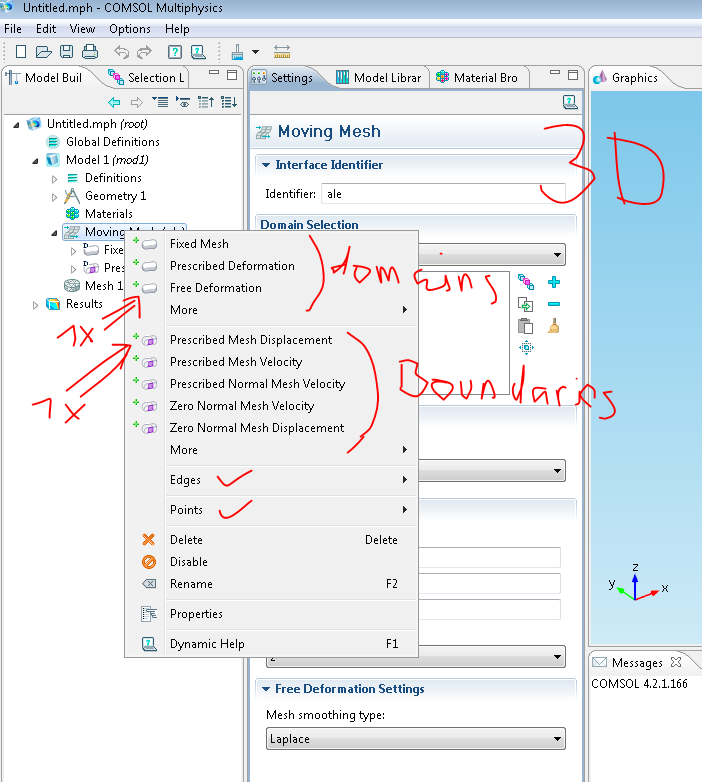

Posted: 1 decade ago 2012/02/25 7:37 JST
you should have ome icons, the first series are for domains, then a line will separate the boundaries, lower the edgs and last the points
Take a look its 4.2a

Posted: 1 decade ago 2012/02/25 8:03 JST
Now I see what are for boundaries and what are for domains. There are the default "Fixed Mesh"(for domain) and "Prescribed mesh displ"(for boundaries) generated with "ale". I can neither modify those nor disable them.
When I add another "Prescribed mesh displ" after "Free Deformation", I can't choose any boundary since they are all (not applicable) just as in the one defiantly generated...
Do you see where my problem is?

Posted: 1 decade ago 2012/02/25 22:15 JST
when you load in a physics, there are a few default nodes that comes with for domains and for boundaries, such that the physics, by default, will be coherent. Tese have a little D in the icon in 4.2a and are always the first nodes, and cannot be deleted, BUT they can be overwritten.
In the main physics node you select the domains that apply to your physics, in the lower subnodes you select all or only some of the domains and corresponding boundries per subnode, BUT you must ensure ALL boundaries of the main physics node are defined at least ONCE, and that enough BC conditions are set for all subphysics to give an unique solution of the PDEs.
Therefore you will see some overrides appear depending on how you combine you node and in which order (top/down) they appear.
If you can add a free DOMAIN, and a Prescribed Displacement Boundary sub node, but cannot select any domain or boundaries, then it means that something is blocking you, from the ALE physics or from another physics.
One important fact: the ALE physics should appear BEFORE (=top) the solid physics node (=bottom) in the node list (note: this is not well documented today, COMSOL has told me they will better document this in the next version) if you mix in the other way around your results will most probably be WRONG !
Solid physics has a type of ALE with the spatial frame approach, therefore the Solid and ALE interact, normally one do not apply ALE to the solid domain, could this be your case, then disable the ALE domains in the solid physics node
Perhaps a screen sshot could help us better understand

Posted: 1 decade ago 2012/02/26 5:48 JST
Thanks. It works now. I somehow disabled the free deformation that is was in shadow....
