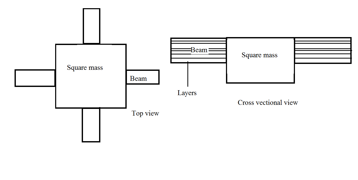

Looks like meshing is a real 'art'. I have attached schematics of my model. All the layers in the beams are attached to the square mass. I tried meshing (sweep) the square first and then meshing the layered beams. No luck.
Tried sweeping layers, converted them and then meshing square mass (both sweep and tetrahedral). Did not work.
Tried to sweep from sides and then meshing the square mass. Did not work either!!
Is there anything left to be tried?
Thanks
Sankha

are your x-y scales isotropic or are the beams very thin ?, one way would be to cut the square at the height of the lower beam boundary, mesh the beams with tri on top and sweep through, then convert the surfaces = boundaries como to the upper square and try toget that one into a fine thet, you should allow for small mesh, reduce the minimum size to about the value of the smallest mesh in the beam section. Thereafter you mes the lower part of the square with a normal thet mesh.
Another way that works 100% but generates very man mesh elements, is to cut the square block along all the layers of your beams, so you have a full transverse "lasagne" plate there (hope you know italian cuisine ;) then you can mesh the full top surface with tri and sweep through the rest of your parts all the way down. You might want to add several dimensions and ensure you have a few layer per layer thickness

I tried to cut the square mass into layers and sweep meshed top 7 layers (which are in contact with the beams) along with the layers of the beams. It worked fine. So, now the only layer left to mesh is the bottom most layer of the square mass. To do this, I first tried sweep mesh. Then I converted the layer in the square mass which is in contact with this layer and use tetrahedral meshing, but that did not work either. I think I am missing something here. Why can't I mesh this layer? This layer is not in contact with the beams!! It's in contact with the square mass only.
When I tried sweep mesh this layer from side, the error was " Failed to copy mesh between edges, from the source face to destination face". When I tried to mesh from bottom surface, the error was "Mesh on source and destination face do not match". Does this have to do with mesh size?
Thickness of the square mass is 5 micron. Beams are 3.3 microns thick. The length of the square mass is 500 microns. The length of the beams is 250 micron and width is 120 micron.

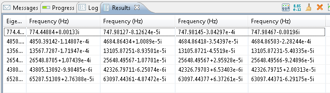

Thanks a lot for replying. I understand that the complex frequencies are obtained because of the damping in the material. "Should we always get complex Eigen frequencies for a layered Piezoelectric resonator?". Because the results that you have sent me are for PZT connected in circuits!!!!
The problem is that I am new to Comsol and I do not know whether I have done the analysis properly or not. It is possible that I have done something wrong somewhere and that is why the imaginary Eigen frequency is arising.
1) Is there a way to check the accuracy of my simulation? How can I make sure that whatever I have done is correct.
2) Is there a way to calculate the error associated with the analysis? When I start modelling, there is this parameter "Relative tolerance". What this number means? The error associated with the analysis depends on this number.

I have not conneced it to any circuit, just left a gnd or a fixed voltage, the terminal is equivalent to adding a thin highly conductive electrode on the top so you have the same voltage over the full electrode.
From the moment you have a PZT that generates voltage when bent, and that you apply a voltage these will interact and you get the equivalent of a damping in the material, and this will depend on the impedance of your supply, hence different frequencies at the output. And complex eigenfrequencies. Check you books on PZT, Prof. Preumont has written several interesting ones ;)

for me a complex eigenfrequency should be seen as a phasor (amplitude and phase) indicating that the response is dephased w.r.t the excitation (you also observe this if one look at the eigenfrequency metallic beam with damping).
The reason why a PZT changes frequency physe in open and closed circuit (charge acumulation and charge exchange) is that the PZT charge generated from the bending of the beam interacts with the bending motion (and differently in charge accumulation and charge exchange mode)

I do not understand why you want to remove this additional information, that is due to the material proerties and the way you drive your device. For me these are essential and part of the model.
If you want to have a real value to work with, use the "phasor" notation and separate the amplitude and phase
lamb = lamb_r + i*lamb_i = sqrt(lamb_r^2+lamb_i^2) * exp(-i*atan(lamb_i, lamb_r))
see also the web with "phasor Wiki" and "phasor Wolfram"
For me there is no reasons neither mahematical nor physical why the eigenfrequencies should be only "real"

Hello Ivar,
It's good to hear from you. I had almost given up on the frequency analysis of my model. But now I feel like trying again. I have done Eigen frequency analysis of my design and have got consistent results. I have used the material properties from the COMSOL materials library. I have used extremely fine mesh and have tried Frequency sweeps close to the resonance frequency and far away from resonance frequency. What I have not done are the followings-
1) Stationary study 2) Have not used "enough damping denied". While I understand statioary study, I do not understand "enough damping". Could you write in short what do you mean by enough damping and how to implement that in Comsol. I think that might work.
Thanks
Sankha
