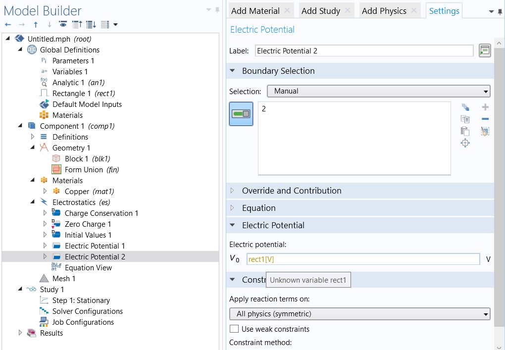

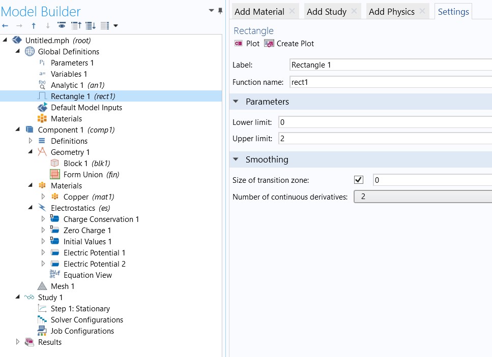

Posted: 5 years ago 2020/07/06 21:14 JST
I was able to do this with analytic funtion, but finding difficult to doit with rectangle. By the way using events work like a charm. I am attaching the screencshot of using the rectangle function as potential, probable some error somewhere.

Posted: 5 years ago 2020/07/06 22:39 JST
rect1 is just the function name. You must call it with some argument.
For example use V0*rect1(sin(2*pi*f*t)) to obtain a periodic rectangular function with frequency f and magnitude V0. V0 and f can then be parameters that you define (in volts and Hz, respectively), whereas t is a built-in variable representing time.
But I think in your case, the function waveform is more appropriate, because you can directly select Type: Square and Angular frequency: f to get the same result.
Anyway, the point is that the function must be called func_name(argument) by something that is time dependent ;-)
`rect1` is just the function name. You must call it with some argument. For example use `V0*rect1(sin(2*pi*f*t))` to obtain a periodic rectangular function with frequency `f` and magnitude `V0`. `V0` and `f` can then be parameters that you define (in volts and Hz, respectively), whereas `t` is a built-in variable representing time. But I think in your case, the function `waveform` is more appropriate, because you can directly select `Type: Square` and `Angular frequency: f` to get the same result. Anyway, the point is that the function must be called `func_name(argument)` by something that is time dependent ;-)
Posted: 5 years ago 2020/07/07 1:10 JST
Thanks Alexis, The problem is solved, I was only giving an argument as t, then my unit of potential won't be voltage. It was V*s, that were the problem. thank you very much for your help.
