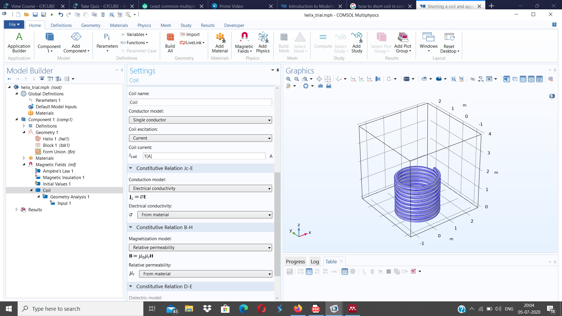

I want a shorted circular coil of 4 turns made of copper material. I am also applyng a ac current of 2A, 10Khz frequency to the coil. As it is not possible to physically join the two ends of coil in comsol, I want to know any other alternative to do the same.
Is it possible to give Voltage=0V and current = 2A,10Khz in the same coil ? If possible on comsol, please give me steps to do it?
Please find the attached image to see how i have done?
i am using comsol 5.5 version.
