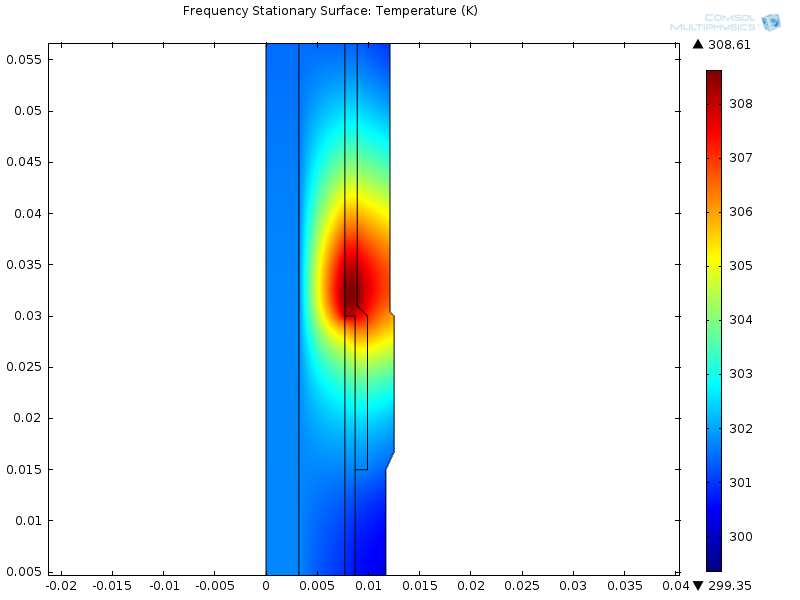

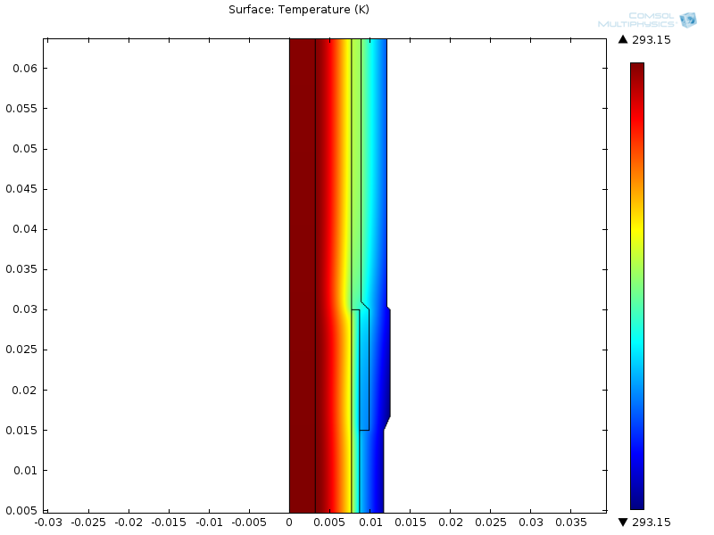

I have joined what I see, file FreqStat is your mesh in freq stationary, then I made the mesh much denser for the regions where the temperature is higest, and added boundry mesh on these 2 domains,"...Dens2", so your mesh isratherrough, ut that is easy to change once it runs ;)
If I use a RMS DV and standard stationary I get the last file, and its almost the same for all mesh density

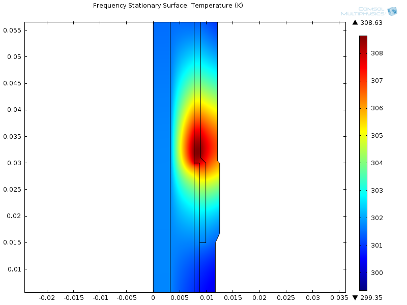

Posted: 1 decade ago 2012/03/04 1:53 JST
and the last file highest density frequency- stationary
I was a bit too quick, the finer mesh is not that much different (I had left the 1/sqrt(2))
