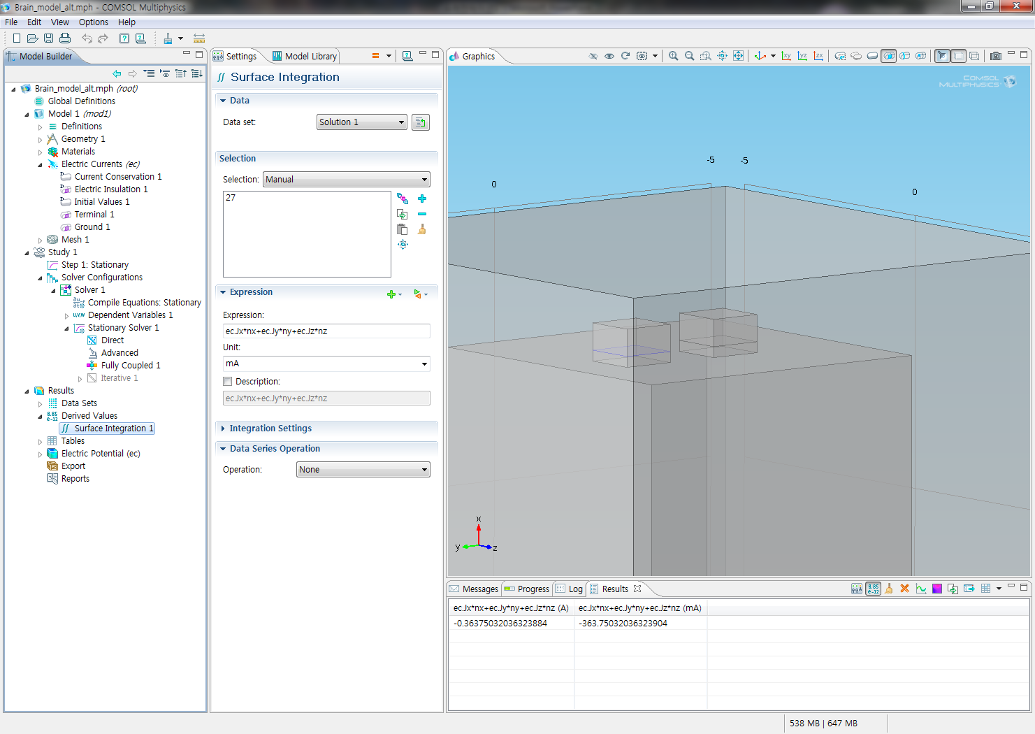

I want to simulate current stimulation, so i made a simple brain model and attached 2 electrodes
one electrode output 1A and the other electrode input 1A using terminal.
but, it cannot be solved by direct solver.
I think, there is a problem of setting boundary condition, but i could not find it.
What is a problem?

Thanks for quickly reply.
I'v replaced terminal 2 by GND node and it works well
but, when i checked current output using Derived Values,
Output current is about 360mA.
I don't know whether measuring current is incorrect or simulation condition is incorrect.
Thanks for quickly reply. I'v replaced terminal 2 by GND node and it works well but, when i checked current output using Derived Values, Output current is about 360mA. I don't know whether measuring current is incorrect or simulation condition is incorrect.

both are "correct", but it seems that you have not read carefully the KB about flux calculations.
if you use a Derived Values Globa Evaluation - variable electric current - port and terminal + ec.I0_1
you will then get a more accurate value obtained with the weak formulation (already integrated over the port area)
if you change the mesh density on your pads you will notice the current change, by the way use rather
ec.normJ = sqrt(realdot(ec.Jx,ec.Jx)+realdot(ec.Jy,ec.Jy)+realdot(ec.Jz,ec.Jz)) Current density norm
than your product, ... or ?
Hi both are "correct", but it seems that you have not read carefully the KB about flux calculations. if you use a Derived Values Globa Evaluation - variable electric current - port and terminal + ec.I0_1 you will then get a more accurate value obtained with the weak formulation (already integrated over the port area) if you change the mesh density on your pads you will notice the current change, by the way use rather ec.normJ = sqrt(realdot(ec.Jx,ec.Jx)+realdot(ec.Jy,ec.Jy)+realdot(ec.Jz,ec.Jz)) Current density norm than your product, ... or ? -- Good luck Ivar

Thank you for your adviser.
By reading KB, I know that when I set terminal condition to the electrode, it is hard to get exact flux value on that surface which I give the terminal condition
Then, If I calculate flux in the other surface, can I sure that value?
For example, I made cylinder electrode in the rectangle model and I set 1mA on the upper side.
After calculation, I measure the current on the lower side of the electrode by surface integration
Then, is the output current proper?
Hi Thank you for your adviser. By reading KB, I know that when I set terminal condition to the electrode, it is hard to get exact flux value on that surface which I give the terminal condition Then, If I calculate flux in the other surface, can I sure that value? For example, I made cylinder electrode in the rectangle model and I set 1mA on the upper side. After calculation, I measure the current on the lower side of the electrode by surface integration Then, is the output current proper?
