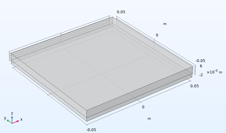

Geometry: Two blocks created, one on top of the other. Assembly formed with contact pair created at midplane for block contact. Materials selected for each block and required properties applied. (See attached image)
Physics: Solid Mechanics physics was selected. Boundary load node applied on top surface of top block. Contact pair node applied to contact pair between the blocks. Fixed face node applied to bottom face of bottom block. Roller node applied to sides of top block.

the contact is the culprit. If both plates are intended to remain permanently attached to each other you don't need it. Comsol takes care of continuity. If you need the contact, this is where you need to refine.

Thank you for the advice. Changing the assembly to a union and removing the contact fixed the issues.
