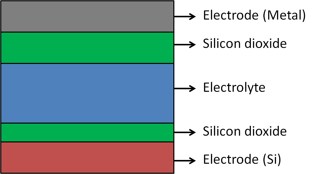

I am trying to simulate a system in which two electrodes are separated by oxides and an electrolyte. I would like to plot potential profile when I apply voltage and ground to the electrodes. *A picture of the system is attached below.* I know the potential drop in electrolyte will be minimal...therefore, my goal is really to figure out what proportion of the voltage is dropped in each of the two oxides.
I am going with 2D to keep it simpler. I was thinking I would have to use the electrostatics interface for potential drop in the oxides and the primary current distribution interface (electrochemistry module) for potential drop in electrolyte. I know I cannot use electrostatics for potential drop in electrolyte since that potential drop is dependent on the conductivity of electrolyte NOT its permittivity. I think the primary current distribution physics only account for ohmic drop in the electrolyte and NOT the electrode-electrolyte reaction kinetics...so it is the simplest case. I made a model and added the two sets of physics and set up the boundary conditions, but I am having trouble getting it to solve (some issue with a phis entry missing in the LU matrix). So, I am wondering if I am using the right approach.
Could someone please help? I can upload the model if you think my approach is right and the problem is in my model. I really appreciate your time! Thanks!
EDIT: Of course there will also be a potential drop in the double layers between the electrolyte and oxides on both sides. Does "secondary current distribution" model this effect of double layers?

Now I can open it. Why in your model file you have only 2 domains? According to the very first picture you uploaded, you should have 5. Then the right setting would be to use one Poisson's equation for electrolyte and the second equation for other 4 domains. Then only for the electrolyte domain you should include source term. And only set one ground BC and one Dirichlet BC with Vapp. You don't need to set anything in between.

The top domain is oxide, then electrolyte, then oxide and then silicon. The top and bottom boundaries of the stack are applied potential and ground. I have defined 3 Poisson equations. The oxides are assumed to have some internal charge. Si is modeled with internal depletion charge. And I have used the modified Poisson-Boltzmann equation for the electrolyte. I am using the equation described in the attached comsol conference paper. I also double checked the equation with Kornyshev's paper titled "Double-Layer in Ionic Liquids: Paradigm Change?"...he actually acknowledges you in that paper! I keep checking my equation and it is correctly input and matches the equations in those papers...but I get a strange result. Could you please take a look?
