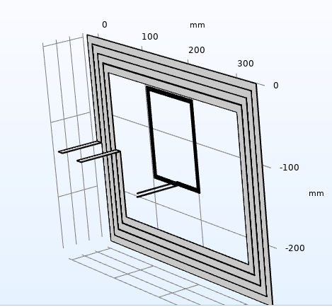

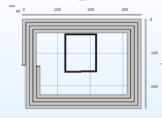

Hello, I am a new user of COMSOL, at the moment I'm trying to build a model of a flat printed transformer. The model includes two square-shaped coils: primary and secondary, located inside the primary.

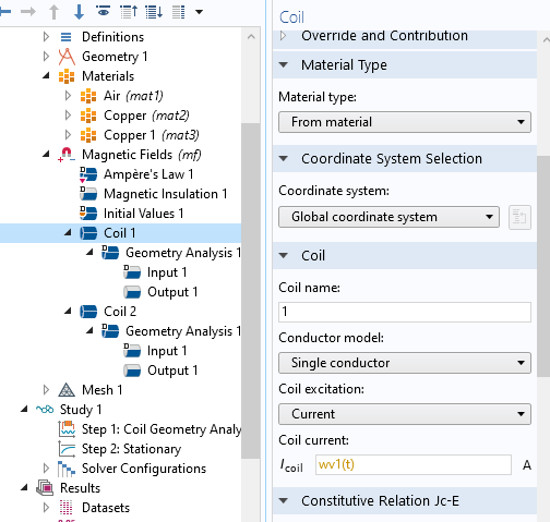

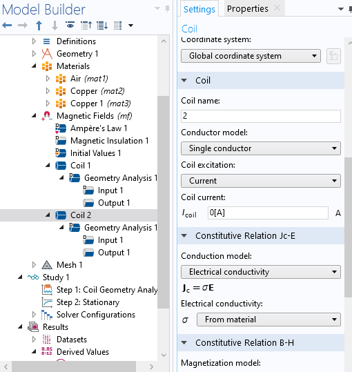

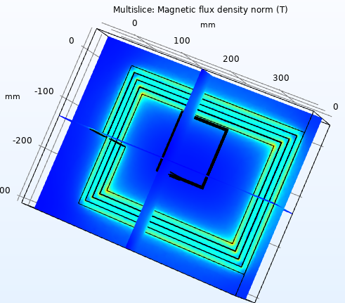

The function of the exciting current in the primary coil is set using the standard built-in function waveform (sin). For each coil, the conditions of the coil are set, the input and output are indicated. The materials of the coils and the working medium are identified. As a result, I can’t get the EMF in the secondary coil, maybe this is due to my poor knowledge of all the functions of COMSOL, and I get the EMF value, but I just can’t get it out for clarity.
If you have encountered such a problem or modeled a similar model, please tell me how to solve this problem or what could be the error. I enclose screenshots of the main parameters and the appearance of the system. Respectfully, Alex
