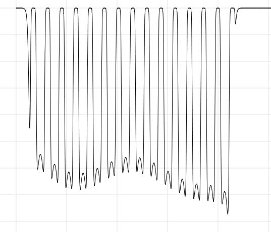

I need to find the average dimple diameter for a number of dimples on a stright surface, The picture attached shows the exactly what I mean.
I have the x and y values i tried to manipulate it in matlab but I just need some ideas. I want to program it in a scrip to make the process easier.

You need to sit down and think about a definition for the diameter that makes sense to your problem. For instance you could use the full-width at half-maximum (FWHM).
Once you have the right definition, finding a procedure is straightforward.
For instance if you use FWHM, the procedure might be
  1. Find all local maximas such that and
  2. For each maximum , search on the left for the first value such that . Likewise search on the right the first value such that . If you already know a bisect search for and for instance would be efficient
  3. FWHM is then simply
Another definition could be using an arbitrary treshold that defines the limit between interior and exterior of a dimple.
Again, once you have clarified for yourself what you mean exactly by "diameter", translating that definition into code is not hard.
