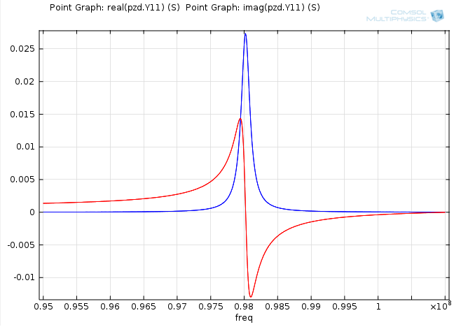

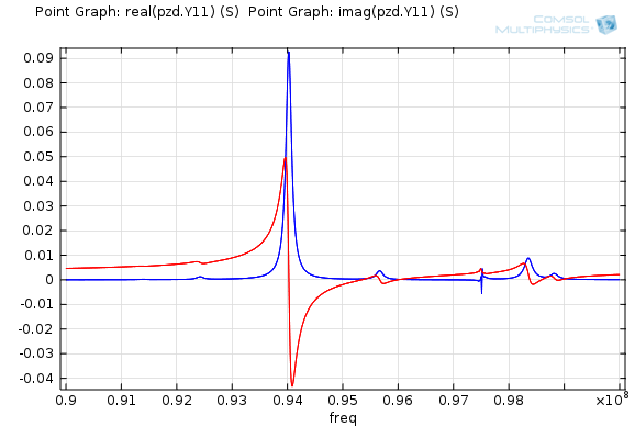

Posted: 1 decade ago 2012/03/22 14:55 JST
i heve posted my two designs that i am tring to implement

Hi Rohan Kumar !
I also design original the single IDT structure first, I find the appropriate frequencies. I then analyzed in the time domain, I want to see the movement of the saw depends on time. I've put a sine wave on the electrodes of IDT. and I've seen results. however, now I want to put pressure on the surface of the sensor, and check the frequency that I applied to the sine wave equation has changed or not., my work did not as expected.
Rohan Kumar,How did you simulate on this change . is it like me ?
Hi Rohan Kumar ! I also design original the single IDT structure first, I find the appropriate frequencies. I then analyzed in the time domain, I want to see the movement of the saw depends on time. I've put a sine wave on the electrodes of IDT. and I've seen results. however, now I want to put pressure on the surface of the sensor, and check the frequency that I applied to the sine wave equation has changed or not., my work did not as expected. Rohan Kumar,How did you simulate on this change . is it like me ?
Posted: 1 decade ago 2012/04/02 17:29 JST
Hi Nguyên Vinh,
yes i simulated the single idt .it is working . i did the frequency analysis of the structure . i found the resonant frequency of the idt 1st then applied the pressure to it . there was a frequency shift because of that.
Hi Nguyên Vinh, yes i simulated the single idt .it is working . i did the frequency analysis of the structure . i found the resonant frequency of the idt 1st then applied the pressure to it . there was a frequency shift because of that.
Posted: 1 decade ago 2012/04/02 17:41 JST
Hi Rohan Kumar !
I simulated also like you. I have seen the frequency change. you do not work in the time domain analysis. in fact, we must apply the sine wave signal and determines the pressure through the change of output frequency.
Hi Rohan Kumar ! I simulated also like you. I have seen the frequency change. you do not work in the time domain analysis. in fact, we must apply the sine wave signal and determines the pressure through the change of output frequency.

Hi Rohan Kumar !
Because of the large file size, I can not post up. I take a page so we can see that
Hi Rohan Kumar ! Because of the large file size, I can not post up. I take a page so we can see that

Posted: 1 decade ago 2012/04/02 18:05 JST
Hi Rohan Kumar !
I just created file as I did before. it is based on modules of COMSOL library. you can change the pressure (large enough) to see the frequency change
Hi Rohan Kumar ! I just created file as I did before. it is based on modules of COMSOL library. you can change the pressure (large enough) to see the frequency change

Posted: 1 decade ago 2012/04/02 22:24 JST
Hi!,
Here are my files. IDT Celda Unitaria is a single IDT, I have performed a frequency analysis to see the admitance. I Also attached this graphic (Admitancia IDT celda con 60 Lambda) . Prueba SAW IDT is a 10 electrodes IDT, with this I have a problem with PML boundaries that I used to avoid the reflections on the material frontiers (The error i get from comsol is "Comsol could not find any spherical or cylindrical regions."). Al so I Attached the results about admitance (Admitancia IDT 10 Electrodos ...).
Please, let me know if you can resolve the problems with PML. I am using COMSOL 4.2a
I have not performed any simulations with pressure yet. How do you simulate the diaphragm bending??
Waiting for your reply.
Regards.
Guillermo Borrero
Hi!, Here are my files. IDT Celda Unitaria is a single IDT, I have performed a frequency analysis to see the admitance. I Also attached this graphic (Admitancia IDT celda con 60 Lambda) . Prueba SAW IDT is a 10 electrodes IDT, with this I have a problem with PML boundaries that I used to avoid the reflections on the material frontiers (The error i get from comsol is "Comsol could not find any spherical or cylindrical regions."). Al so I Attached the results about admitance (Admitancia IDT 10 Electrodos ...). Please, let me know if you can resolve the problems with PML. I am using COMSOL 4.2a I have not performed any simulations with pressure yet. How do you simulate the diaphragm bending?? Waiting for your reply. Regards. Guillermo Borrero

Posted: 1 decade ago 2012/04/04 1:16 JST
Hi Guillermo,
i am doing what you are planning to do . i have a elastic diaphragm on which the subsrate beam is placed on which the saw sensor is mounted. i am giving a pessure from he bottom of the diaphragm . i will send you the design of the structure tommorow.
Regards
Rohan
Hi Guillermo, i am doing what you are planning to do . i have a elastic diaphragm on which the subsrate beam is placed on which the saw sensor is mounted. i am giving a pessure from he bottom of the diaphragm . i will send you the design of the structure tommorow. Regards Rohan
