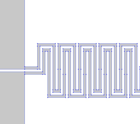

                                                    Looks like you must remove the points inside the straight lines before extruding. Or construct the meander with a polygon.

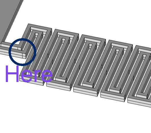

                                                    Is there any way to remove those points?
I don't see any Union or Conversion options to do that.
I've attached the model in this link (the model is more than 5-MB):
https://drive.google.com/file/d/1AIY-FJc3_uztqrbJhTl09hU0ohLHzNke/view?usp=sharing

                                                    Check the 'Remove Entities' function in the geometry menu.
