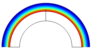

I have an update on this:
In my 2D half cylinder, I added a line from the inner to the outer boundary, exactly half way from the two ends. COMSOL automatically considers it an interior boundary, where the continuity is also met, and I did not need to add any boundary condition for it. Then I constrained that interior boundary by setting the Prescribed Displacement in x direction equal to zero, and it worked very well as the attached picture shows.
Jessica
