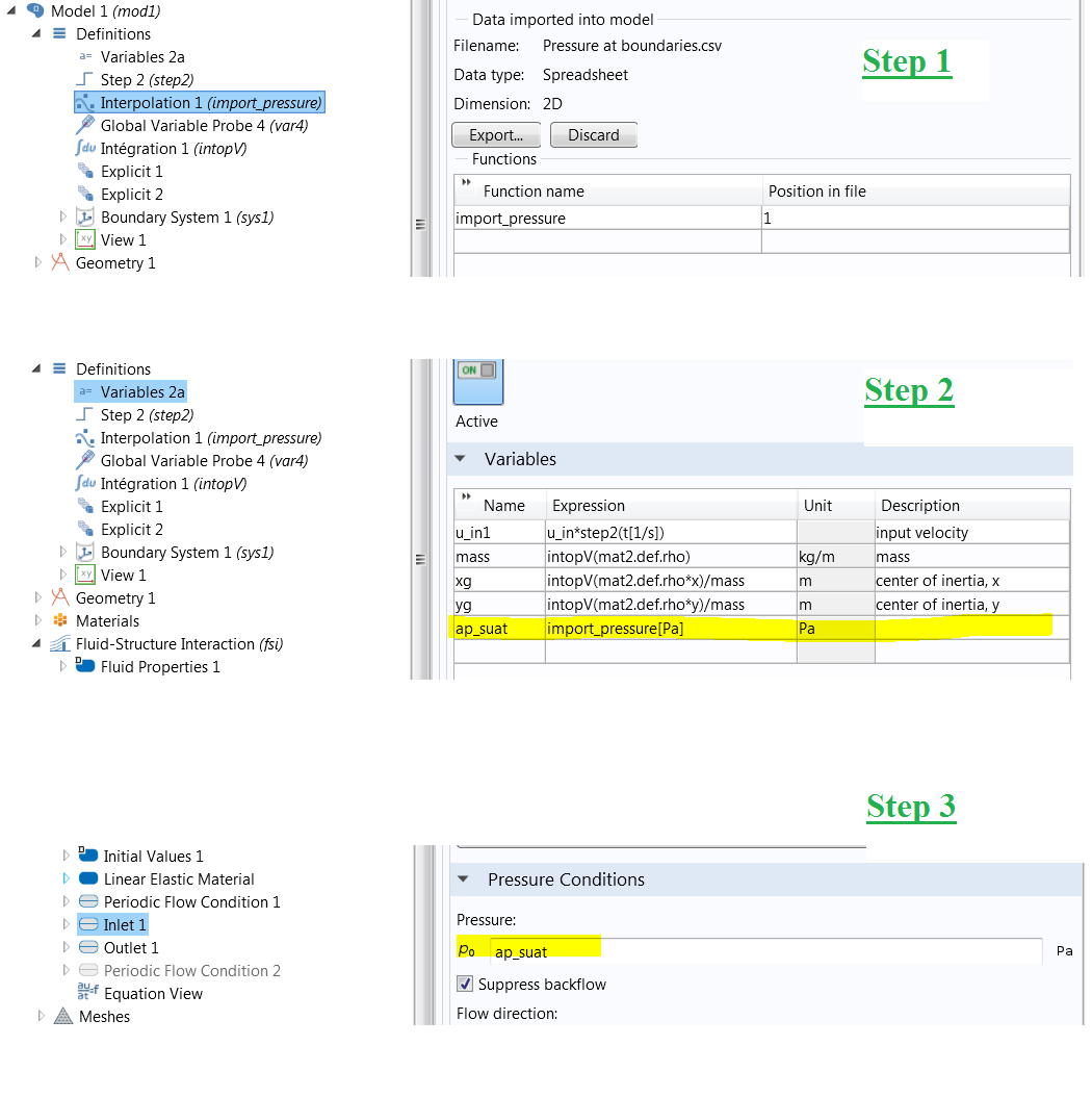

This is too late for you but it may be useful for others.
In Model 2, you create a new variable and point it to the imported function.
In your boundary condition, use the variable.
See the image for more details.
UPDATE: I found that my step of defining a new variable is redundant. You can read this article on COMSOL blog:
www.comsol.se/blogs/using-point-cloud-data-in-your-comsol-model/
Remember to specify the units for arguments and function in the settings of your interpolation function. You might encounter problem when, for example, the coordinates of your imported data is in micro meter but you don't tell the software about that.
