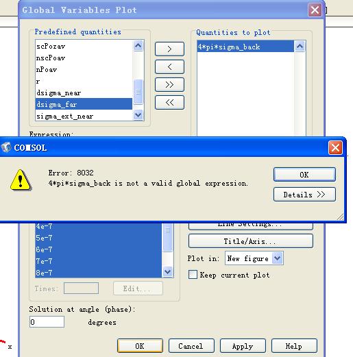

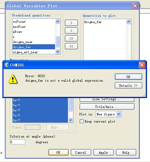

Hi, I am happy to find your example about radar cross section. But I met a problem when I fllowed your example. It happend in Global Expression(dsigma_near, dsigma_far). When I want to plot 4*pi*sigma_back, I met the problem as fllowed: disgma_far is not a valid global experssion. I do not know why.

I believe there is a quick reply for your units issue the "r/1[m]" this gives [m] if "r" is without units, or [m^2] as I expect "r" is in [m] and is different from "r/(1[m])" which is without units or equivalent to understanding it as (r[m])/(1[m])
Will have to look closer for the global expression, but I'm a t a Comsol course just now ;) and Ihave to liten to the speaker too ;)
Have a nice day
Hi I believe there is a quick reply for your units issue the "r/1[m]" this gives [m] if "r" is without units, or [m^2] as I expect "r" is in [m] and is different from "r/(1[m])" which is without units or equivalent to understanding it as (r[m])/(1[m]) Will have to look closer for the global expression, but I'm a t a Comsol course just now ;) and Ihave to liten to the speaker too ;) Have a nice day Ivar

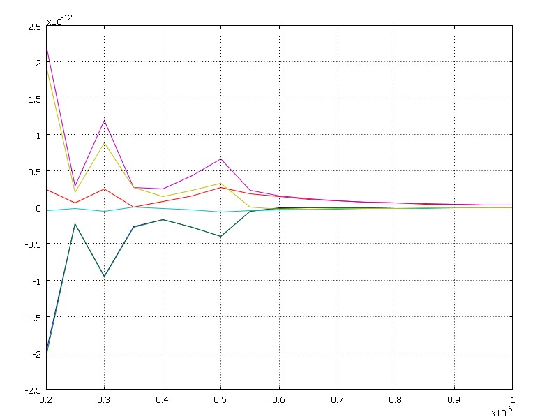

There is serious discrepancy between my results and in results given in the presentation (different field enhancment and cross-sections that are negative at some wavelengths). I used my own data for the refraction index though it also was teken from johnson&christy (1972) paper - I've built interpolated functions with dependence on the wavelength.

I have the same problem with the model; for some wavelengths the scattering cross section becomes negative which makes, of course, nonsense. First I thought it was probably a mistake I made while defining the global expressions or the integration ones, so I repeated the process several times but I obtained the same result over and over. Later I thought that maybe one of the steps in the documentation file was wrong, so I ended downloading the file .mph directly from the model gallery instead of trying to reproduce it myself. Everything was already defined in the file so I just had to mesh the model and solve it. To do so I followed the instructions (mesh size, number of layers in the exterior subdomain, solver parameters,...) exactly as they were written in the documentation. It was a big surprise to find out that I had exactly the same problem as before. I wanted to attach the scattering cross-sections obtained with the downloaded file (Mie_scattering_plasmonic_reset_35a1.mph) to illustrate the problem but the attach button is not responding. Anyway, any idea about what could be wrong?

So did the problem of negative cross-section resolve? I am trying to reproduce the results and facing the exact same problem.
Posted: 2 decades ago 2010/11/02 6:22 GMT-4
Are you using COMSOL version 3.5?
I had the same problem, but it was solved after installing the latest hotfix.
Are you using COMSOL version 3.5? I had the same problem, but it was solved after installing the latest hotfix.
