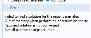

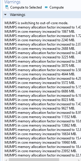

The file is too large so out of memory is shown. I am not sure that the attached file is going on a right direction. Is there anybody who helps me to see if it is correct to get my final goal and if the file is correct, is there any solutions to reduce the memory in this file? I have a lot of problem on mesh actually. If you can suggest mesh, please give me advice on that.. it is really tricky.
I have attached the file with deleted mesh and solution since the file is too large. I put the error on the solution here.

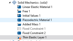

Thank you for replying to me! Do you mean thin elastic layer like the picture? and should I delete the metal which has 0.0001mm thickness? or just set up the thin elastic layer (which should be conducted by boundary selection) on the 0.0001mm thickness metal?

I mean the diameter of electrode is smaller than the diameter of quartz so I made a metal which has 0.0001mm thickness and a diameter 12.7mm on Geometry. If it should be removed, should I set up boudary for thin metal which has the same diameter of quarz using a thin elastic layer ? Acutally, Quartz has the tiny thickness also, should it be dealt with as a Thin Elastic Layer?
