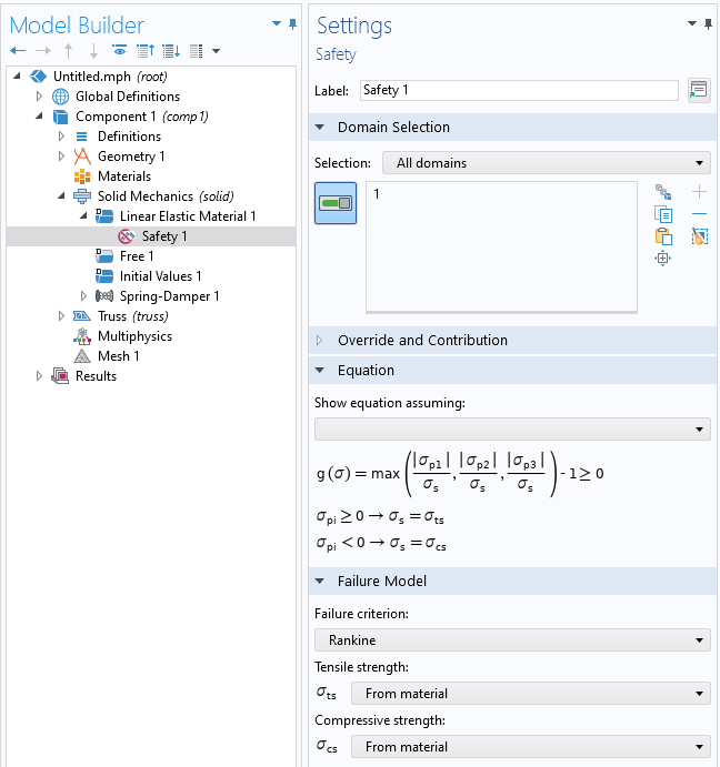

Posted: 5 years ago 2020/10/22 15:36 JST
The Rankine criterion is built-in; see the attached screenshot.
Henrik Sönnerlind
COMSOL
