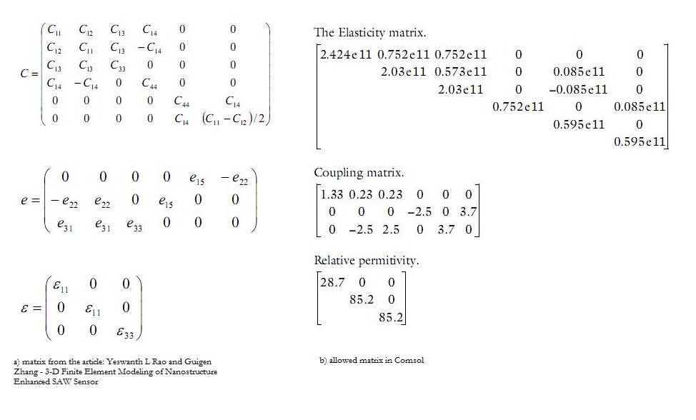

Posted: 1 decade ago 2012/07/03 5:29 GMT-4
Ok, I will try to simplify my question, by attaching a picture.
How do I go from the elasticity matrix a), which is the one I find in the articles, to matrix b), the one allowed in Comsol?
Or, is there a different way Comsol defines this matrix?
Thank you,
Ok, I will try to simplify my question, by attaching a picture. How do I go from the elasticity matrix a), which is the one I find in the articles, to matrix b), the one allowed in Comsol? Or, is there a different way Comsol defines this matrix? Thank you,
Posted: 1 decade ago 2012/07/03 10:03 GMT-4
It seems that the difference between (a) and (b) is only due to the order of the stress and strain variables. Variable #3 in (a) is variable #1 in (b), etc. Matrix C is the elasticity matrix which you can input directly in COMSOL using the “Anisotropic” option discussed above.
Nagi Elabbasi
Veryst Engineering
It seems that the difference between (a) and (b) is only due to the order of the stress and strain variables. Variable #3 in (a) is variable #1 in (b), etc. Matrix C is the elasticity matrix which you can input directly in COMSOL using the “Anisotropic” option discussed above. Nagi Elabbasi Veryst Engineering
