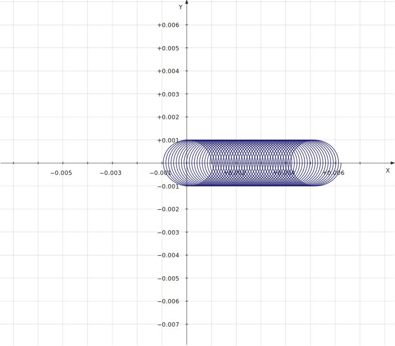

I would like to simulate the temperature field (3D) in a large plate resulting from a Laser beam following a Lissajous figure combined with a feed motion (see attached plot). I have already decided to model the Laser beam as a volume distributed heat source using the heat transfer application mode (ht).
The problem I am encountering at the moment and on which I would like to hear your suggestions, is the extreme difference in size between the Lissajous figure and the diameter of the beam. As I need a certain mesh density to resolve the heat source representing the Laser (at least 5 elements across the diameter of the Laser) I get an extremely high number of mesh elements when applying this mesh density to the whole area covered by the Lissajous figure, even for comparably small plates.
