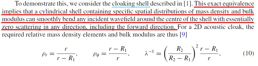

I'm doing acoustic cloaking with comsol .I know that ρ in r-direction is r/(r-R) and ρ in φ-direction is (r-R)/r. I don't know how to set these two function in material density. could you help me with this?
[QUOTE] Normally you talk about anisotropy in case directions are involved. E.g. anisotropic Youngs Modulus. This could be expressed by matrices or tensors. You probably mean non-uniform density. In this case you need to find a function that describes the density, probably as a function of location in space, find a suitable coordinate system and use this function as your expression for the density in the domain of interest. Cheers Edgar [/QUOTE] I'm doing acoustic cloaking with comsol .I know that ρ in r-direction is r/(r-R) and ρ in φ-direction is (r-R)/r. I don't know how to set these two function in material density. could you help me with this?

I'm doing acoustic cloaking with comsol . It shows that density in r-direction is r/(r-R) and density in φ-direction is (r-R)/r. I don't know how to set these two function in material density.
[QUOTE] I have difficulties understanding how a material can have a different density depending on the direction. Does that mean it weighs different depending on how you hold it? Location I understand, but not direction. [/QUOTE] I'm doing acoustic cloaking with comsol . It shows that density in r-direction is r/(r-R) and density in φ-direction is (r-R)/r. I don't know how to set these two function in material density.

I think this citation shows how to define the local density as a function of r and phi. This is what you must implement in COMSOL. So the density is a function of location and the location is in turn a function of the coordinates r and phi.

I am not familiar with cloaking, but it seems that the density you need is really anisotropic (different in different directions) and not just non-homogeneous (varies with locations). What you need for that is density implemented as a tensor instead of a scalar. I have not seen that implemented before for density, but this is how an anisotropic thermal expansion coefficient, or thermal conductivity are implemented. It can be done by modifying the inertia terms in the COMSOL equations. Very interesting!
