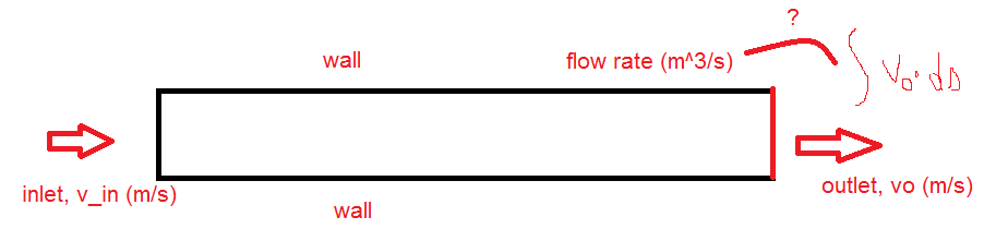

Posted: 1 decade ago 2012/09/07 20:00 JST
Dear Ivar,
Considering the 2D case, the geometry being a shape of a rectangle.
To calculate the volumetric flow rate at the exit, I do: integrate u * ds? or
u * dx on the border.
Thanks
Dear Ivar, Considering the 2D case, the geometry being a shape of a rectangle. To calculate the volumetric flow rate at the exit, I do: integrate u * ds? or u * dx on the border. Thanks
Posted: 1 decade ago 2012/09/07 23:17 JST
Well "s" (ds being the elementary entity length, mainly for lines in 2D, is defined from 0 to 1 along any edge in the direction of the entitiy direction arrow (COMSOL decides which direction, you can turn on the arrow representation to check), while x is the true coordinate, so if you integrate ds you get the total length, while integrating dx you get the x component. I believe you can say, in all generality that ds = +/- sqrt(dx^2+dy^2+dz^2)/Length *1[m] as ds has a dimension of length, and the sign is defined by convention

The best is to check out such things on simple examples, take a long rectangle, put ina normalised parabolic flow integrate velocity along the input and output and check the coherence of the results, you will soon get the grasp of how to use the integration. One thing, always check your units, as this mostly tells you if you have missed a dimension in your equation, such as the 2D depth that is easily forgotten, or the 2D.axi loop length 2*pi*r ...
