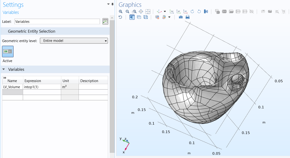

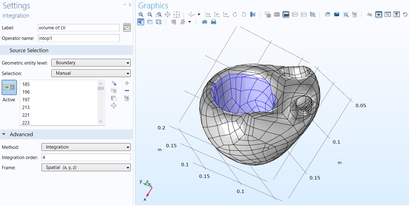

I am currently working on mechanical modeling of the heart; in my simulation I need to compute the volume change of the left cavity under applying a pressure load to it. I know that for such a purpose I should use the integral operator in the definition tab under component coupling. I used this operator and selected the boundaries that I wanted to be integrated, as shown in the picture(intop1) that I attached here, after that I defined a variable named (LV_Volume) and used the operator intop1 to evaluate the volume as shown in the picture (Variable_LV_Volume) that I attached, but the variable computes the surface area not the volume of the boundary. What expression should I use for the intop1 operator to compute the Volume of the boundary? Thank you in advance for any help that might be provided by anyone.

Bottom line: an open surface does not define a volume. A closed one does and that volume can be computed by a surface integral via Gauss's theorem (a.k.a. the divergence theorem). You can go that route if you first ensure your cavity forms a closed boundary; this does not seem to be currently the case judging by the screenshot you attached earlier.

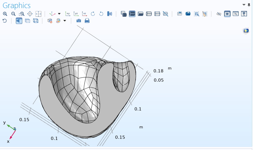

My geometry has one domain and that is the whole geometry, I have created the geometry from medical images in a software named MIMICS and then imported the IGES format of the geometry to COMSOL Multiphysics. As you can see from the picture (Geometry) that is attached, my model has volume and it is not a surface model. I am trying to model the heart without including any of the blood within it and the effect of the blood is considered by a time varying pressure load over the cavities.
