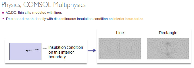

Does anyone have any idea how to do what is indicated in the attached? It is exactly what I need to do (form an electrically resistive slit) and it is mentioned like this in all the 4.0a release notes but I cannot find any details on how this is achieved.
For a start I cannot seem to simply draw a line even!?
Is anyone able to point me in the right direction with this one?
Thank you!

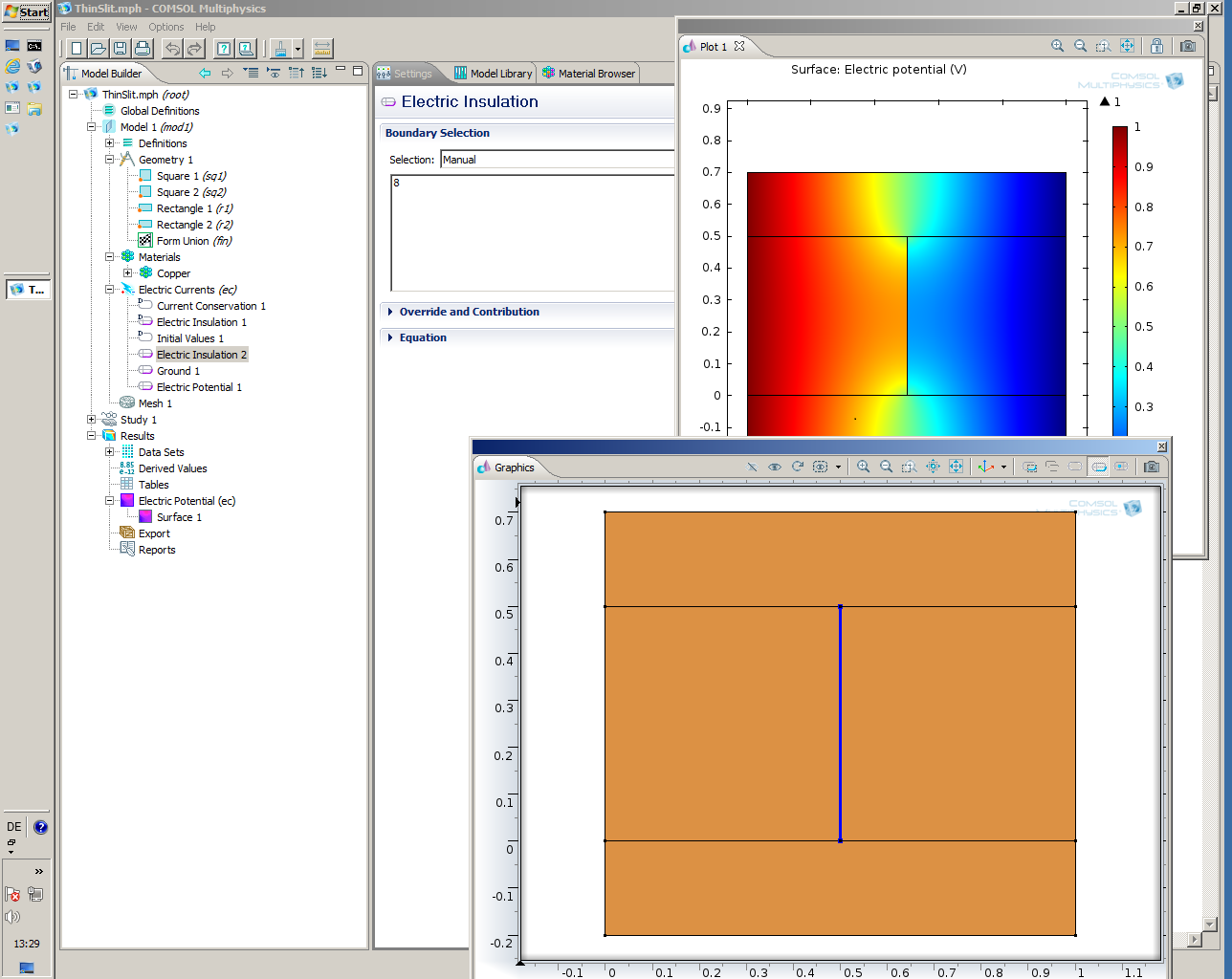

Would something like this do what you want?
Cheers
Edgar
Would something like this do what you want? Cheers Edgar

Posted: 1 decade ago 2012/04/03 19:34 JST
Sadly it looks like the update is going to be a next to impossible task. Would it be possible to take a screenshot of the model builder tree for me to see the structure of how you've created yours?
Thank you so much.
Sadly it looks like the update is going to be a next to impossible task. Would it be possible to take a screenshot of the model builder tree for me to see the structure of how you've created yours? Thank you so much.
Posted: 1 decade ago 2012/04/03 20:43 JST
Here is the screenshot. I assembled those 4 domains, all are copper. This way I could set the internal boundary to insulation. Left and right boundary are set to 1V potential and ground. The other internal boundaries are continuous as default.
Cheers
Edgar
Here is the screenshot. I assembled those 4 domains, all are copper. This way I could set the internal boundary to insulation. Left and right boundary are set to 1V potential and ground. The other internal boundaries are continuous as default. Cheers Edgar
